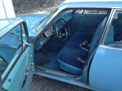

see photos from 2014 when i bought the car. Still looks the same!
