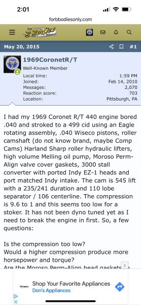

I had my 1969 Coronet R/T at a shop to see if they can help with a run on issue (dieseling). They rebuilt my carburetor and used engine cleaner to get what they believed was a carbon build up. Lastly, they adjusted my timing. I picked the car up and it ran fine although it seemed sluggish. The next morning, it was back firing like crazy and finally stopped after warning up. The timing must be off and is stills diesels after a hard run. What should the timing be set?
499 cid engine. The cam is 545 lift with a 235/241 duration and 110 lobe separator / 106 centerline. The compression is 9.6 to 1.

Engine details
