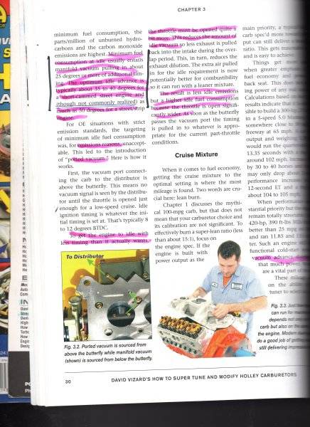

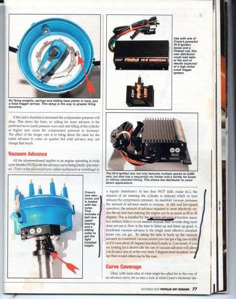

36* of idle timing suggests a cam of some duration/overlap. And it is NOT excessive if that is what the engine wants. There are different ways to get the reqd timing. The easiest way is to use manifold connected vac adv with an adjustable VA unit with the spring set to the softest setting [ Allen Key fully CW ].
See MVA benefits below..
