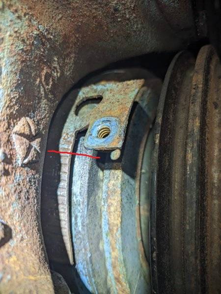

I need to set the timing at 5 degrees. Can't see the numbers on the plate. Does anyone know where 5 degrees is? 1978 400 engine
On my phone it looks like the first mark on top is zero. Then 2 degrees every mark. With 10,20, & 30 labeled.
In the past when hard to read Get out dome white paint and fill the low spots.
