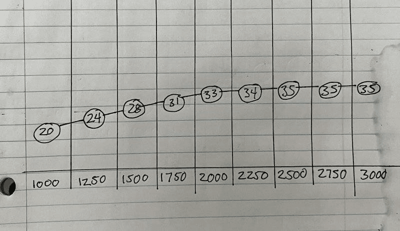

This was the curve of my car after working on the distributor a bit:
Just to clarify....That is 20 degrees initial, 35 total with the full advance being in place between 2250 and 2500 rpms.
This works for me but may not be optimal for you. My heavy initial timing number is needed for my engine since I have a pretty rowdy camshaft.
Stock distributors may have 24-28 degrees of mechanical advance built into them, meaning if you set the initial at 10 degrees, you may end up with a 34-38 degree number at 3000 rpms. This probably isn't too much for you. Feel free to experiment and see what feels right.
