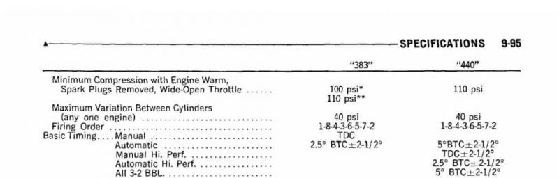

Looking for what the Static and Mechanical should be on a 1970 383.
4spd or auto? Stock or warmed over? What gear? Vacuum advance or not? Points or electronic?
4spd, stock, 4:10, vac advance, electronic ign.
1970 ignition timing.jpgThis is what the factory manual has for 1970 timing:
