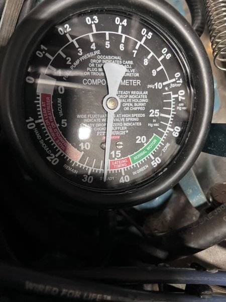

I currently have the idle at about 900, the timing set to 18 BTDC and at idle the vacuum is at 12, which seems very low? Could the camshaft kill the vacuum that much? I thought I’d try setting the idle mix screws to maximum vacuum, but they don’t have any effect - unless I have the timing set above 40 BTDC. Currently I have them each two turns out from seated.

[5] About 12" of vac with low timing is about what I would expect with that cam. With idle timing increased to about 40*, I would expect vac to increase 1-2".
