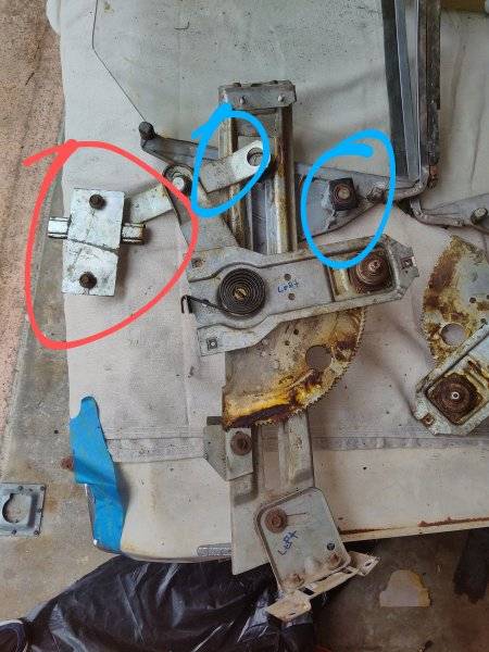

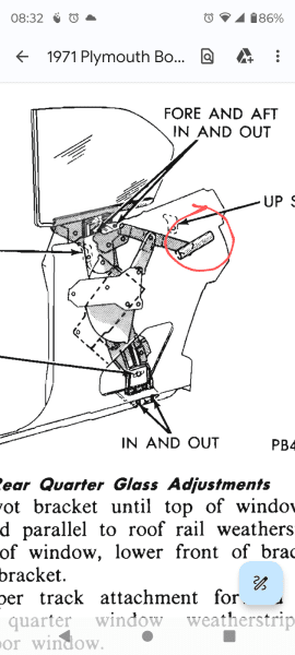

I am installing the rear quarters in my current project 72 Charger. All was out when I got it. I have all the parts shown above (same as copy in my shop manual). I gather the top right with roller on end goes into the existing channel for it. I have removed the track assembly and attached the glass etc to it and ready to drop all in and attach to the regulator. Only problem is I see a cylinder about 1/2 in diameter attached to the regulator sticking out to the field side (not shown on diagram). Don't know what it is for or if I need to attach it to anything. Can anyone tell me its' purpose?
I think this is what you mean. There is a bracket that bolts to the same side as the regulator and the slider on the pivot arm rides in it
I finally got them installed. The trick was to remove the regulator then install the regulator to slider to window all together then feed all in while feeding the pivot bracket into its channel before dumping the whole assy to the bottom. Earlier while trying to do it without removing the regulater I managed to skratch the tinting on the left one. Will fix that later.
