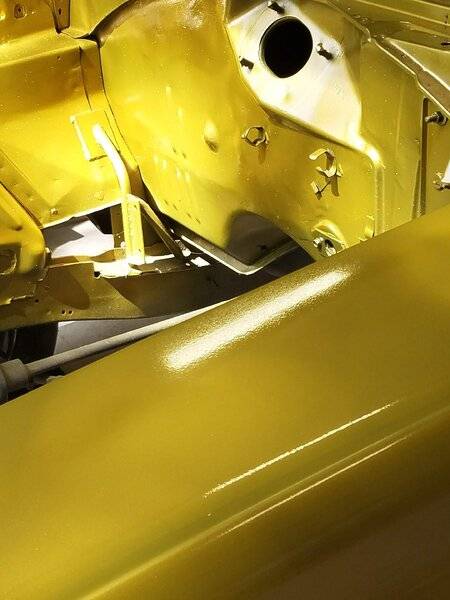

I bought a TCP gun and doing this for the first time had the same issue, the top sides were the worst. Its not perfect but was able to cut and buff it out with various pads and compounds.
Yours looks pretty good from the pics.
