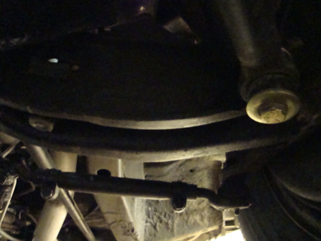

dont think they're boxed...
If they (the lower control arms) were 'boxed', you would have a flat piece of metal welded to the underside of the lower control arm itself...covering that space between the front channel and rear channel where the torsion bar adjuster bolt resides. It would likely have a hole in it just big enough to adjust that bolt.
If you do them both BEFORE pressing the car into service AND get it aligned before pressing it into service, it does not make a hill of beans difference which you do first.
Cool. ya it will be all aligned before it hits the road again.
well, they're not boxed. how big of sway bar can i get before it messes up the LCA's? the current, stock sway bar measures 1.06.

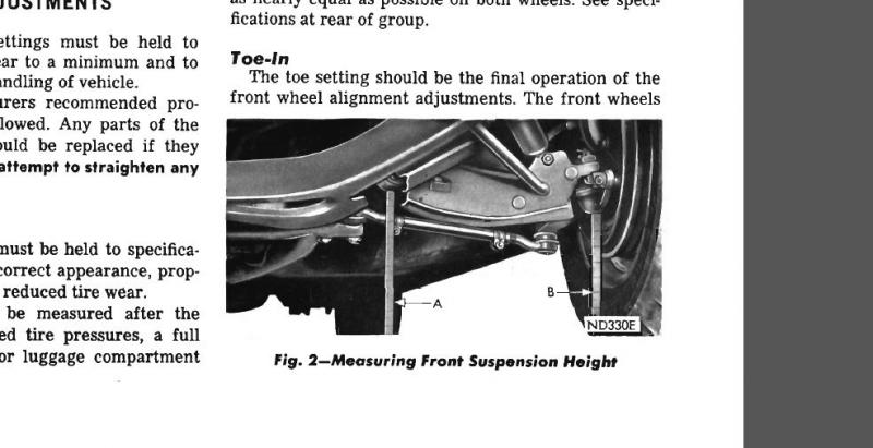

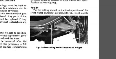

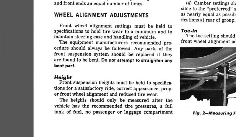

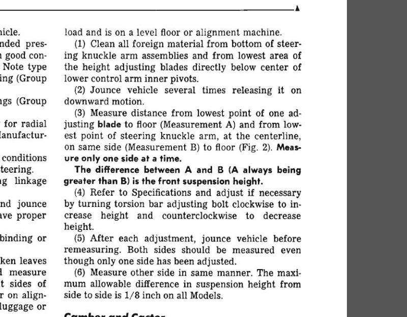

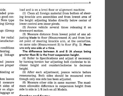

Mario......Matching/watching thread count/turns on the torsion bar adjusting bolts really won't do you much good. Especially if the bars are older or worn. My Roadrunners are 1/2" off from each other to make her sit level and they're brand new Firm Feel bars. You wanna match ride height. Below is out of the '69 Plymouth FSM for adjusting ride height, just in case you didn't have it. Below that is a link for a great article on Mopar Cast/Camber/Toe and some settings. Made a real big difference on my Coronet playing with the chart measurements in the article. I honestly would spend the $50-75 bucks for an alignment if you added new rubber and a different tire design on top of that. Just my 2 cents...If I were you, I would probably just sit down and have a few Leinnie's..screw it.
http://www.allpar.com/history/mopar/front-end-alignment.html
