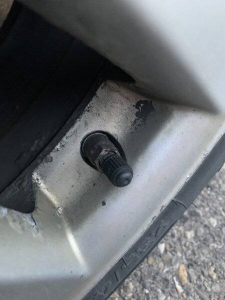

These valve stems are all rubber, like normal.
Not the kind that bolt together with a rubber O ring between.

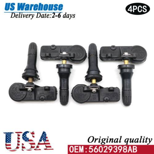

They should be like these.
except mine dont have metal caps
Nope.
All rubber form the factory.
Like these-

Maybe I'll just buy a set of those I pictured.
