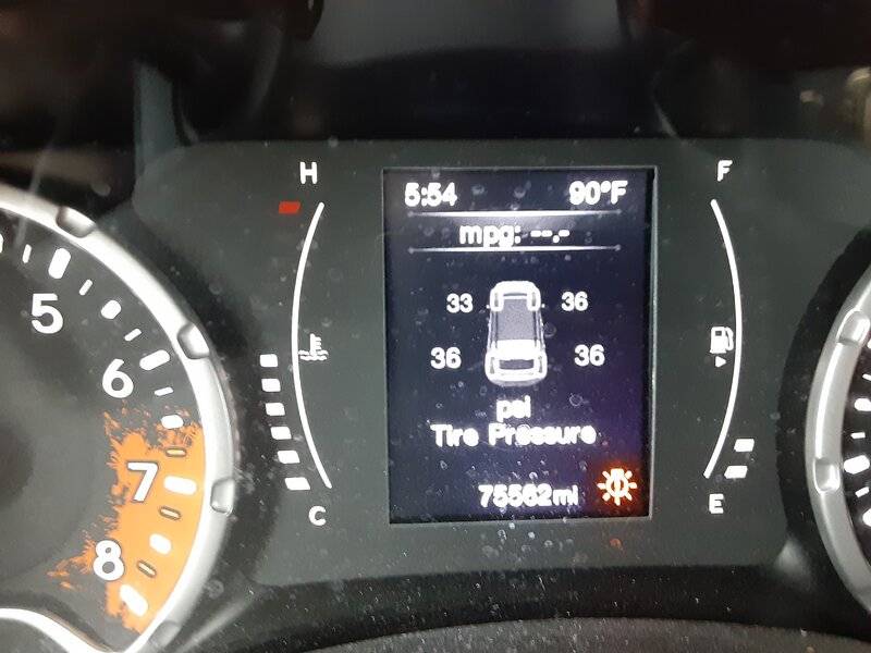

Tire pressure sensor- UGH. Test or replace?

Still not happy about whoever wrote the program to disable the entire system if one sensor fails.
I think I fixed it.

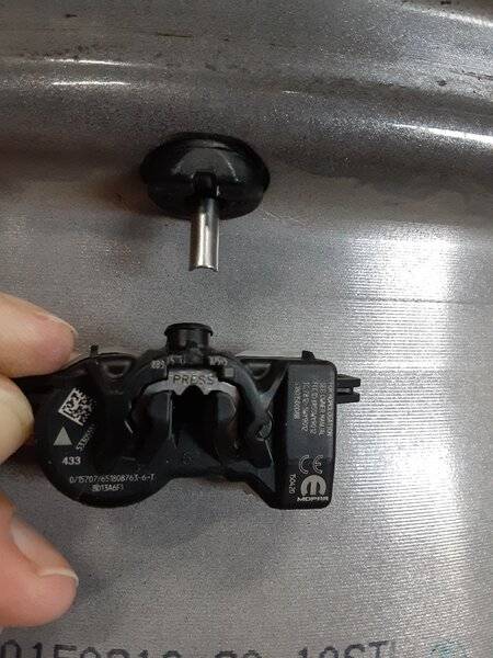

Looks like mine have a press/friction fit stainless tube that presses into the valve stem from the bottom, and has a notch to catch a spring on the sensor (note "press" on the spring).
I found the sensor along with the tube laying in the tire I took off.
I broke the outside bead on the new tire, used a C clamp to press the SS tube in, and clipped the sensor back on.
It started working in less than a minute and the warning light went out about a minute later.
It has made the 23 mile drive to work this morning, and we shall see if my C clamp press will hold the tube in more permanently.

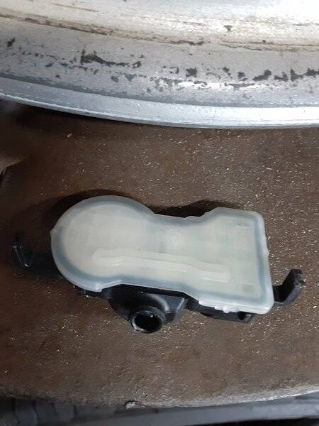

Text on sensor says "replace every dismount".
That sounds expensive.
Looks to have a standard 2025/2032 watch battery inside and looks like it could be replaced if you really wanted to.
The hardest part was holding the bead down out of the way to work.
