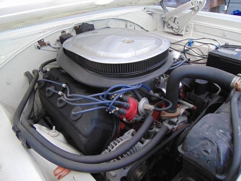

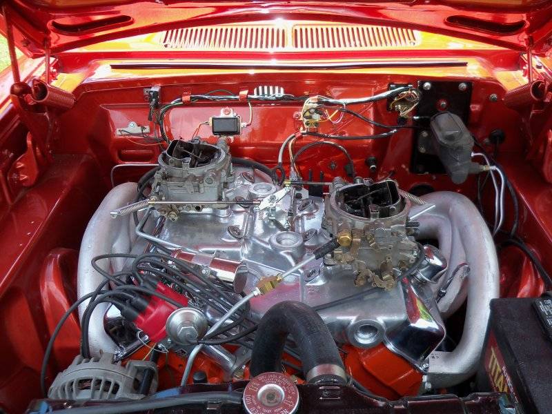

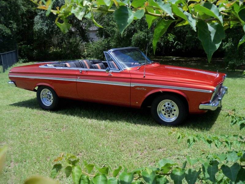

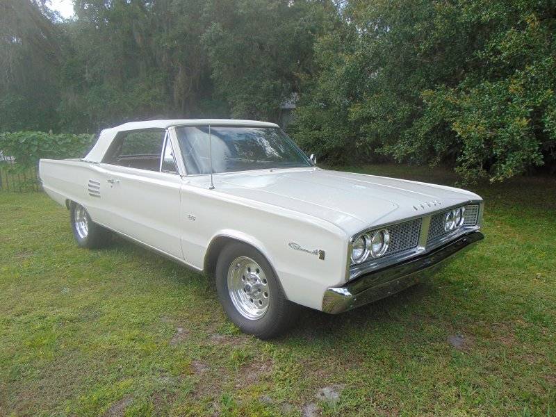

I have two of my 7 mopars that have TKO-600 5-speed transmissions with the 36% over drive that are bolted to a 426 aluminum head very healthy Max Wedge in a 63 Sport Fury convertible and a 432 cu in 426 Hemi in a 66 Coronet 500 convertible and currently run P-255-70R-15 tires on the rear and P225-70R -15s on the front--looks great--handles great BUT--both cars will do 140 in 3rd gear according to my GPS 200 mph speedometer and Id like to put W-or Y-or Z rated tires on these cars but most are very short and I dont want the cars to look like match box cars. So I was hoping some one might know of tires to fill the bill. The fronts are 27.37 tall and 7.2 wide at the tread and the rears are 29 inches tall-and 8.20 wide at the tread ---To be clear--I dont plan on doing alot of hi speed driveing but Id feel alot better about moments of insanity with higher rated tires--16 or 17 inch rims would be fine as I will most likely need the taller rims to get the look .
