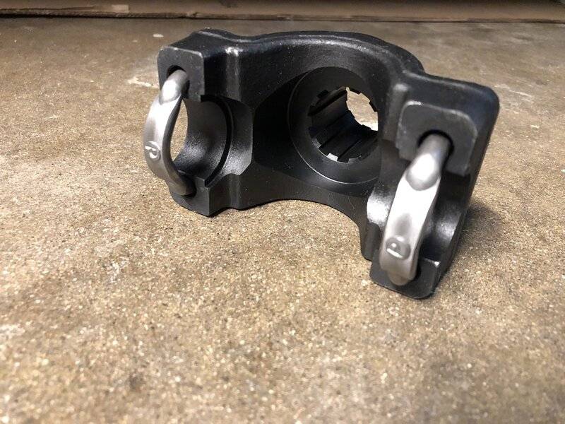

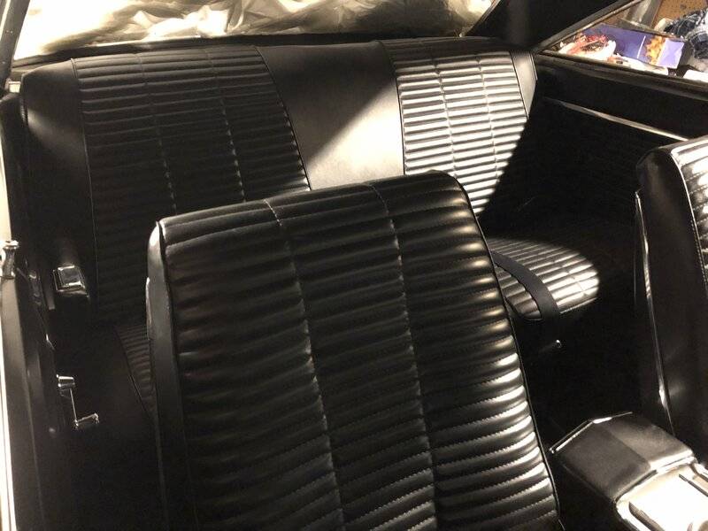

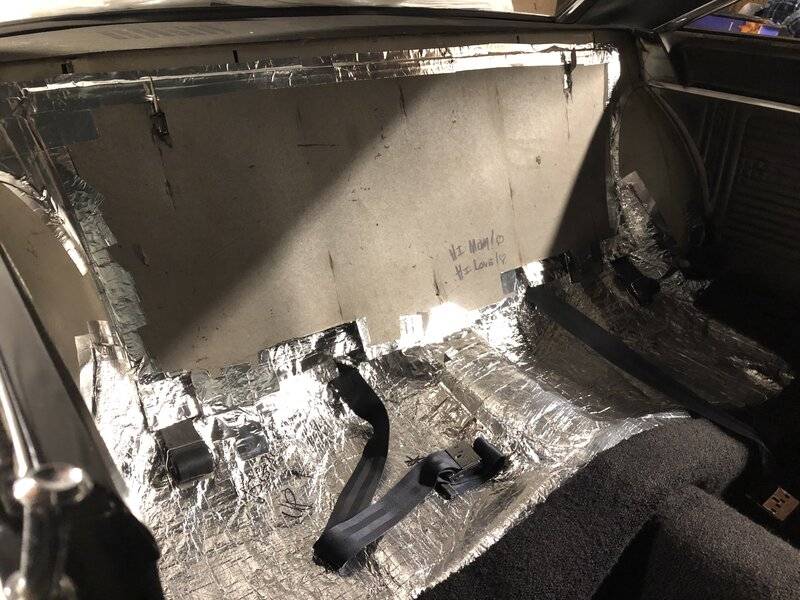

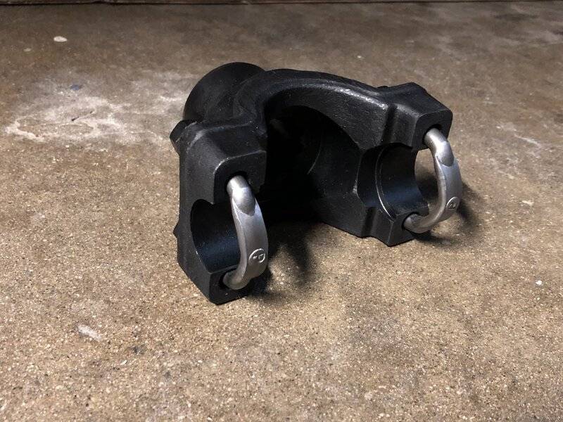

got a new 7290 differential yoke for the 8.75” from Dr Diff. waiting for the 1330/7290 combo ujoint from summit. ill need to make a little firewall patch panel then toss in rear seats.

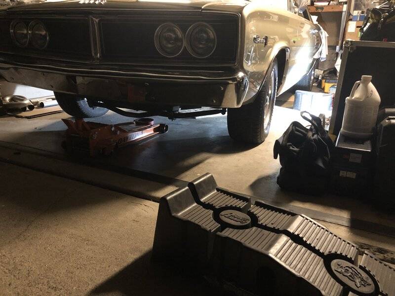

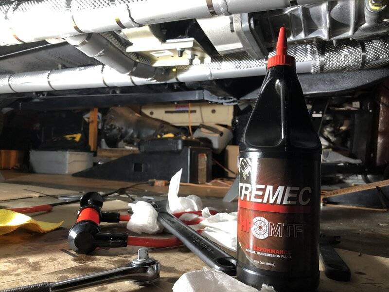

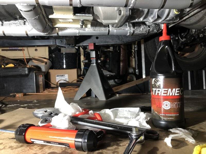

got the transmission filled with three quarts of the good stuff from the SST kit. got the car lowered onto all four wheels for the first time in nearly a year (just a few mins before an earthquake too).
skipping the yoke upgrade for now. getting lazy.

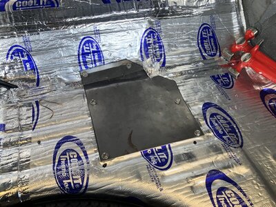

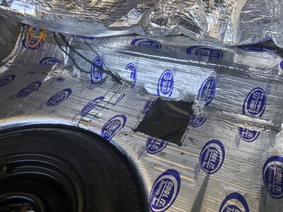

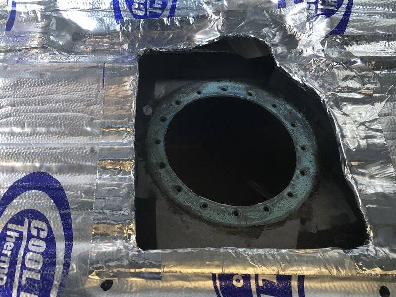

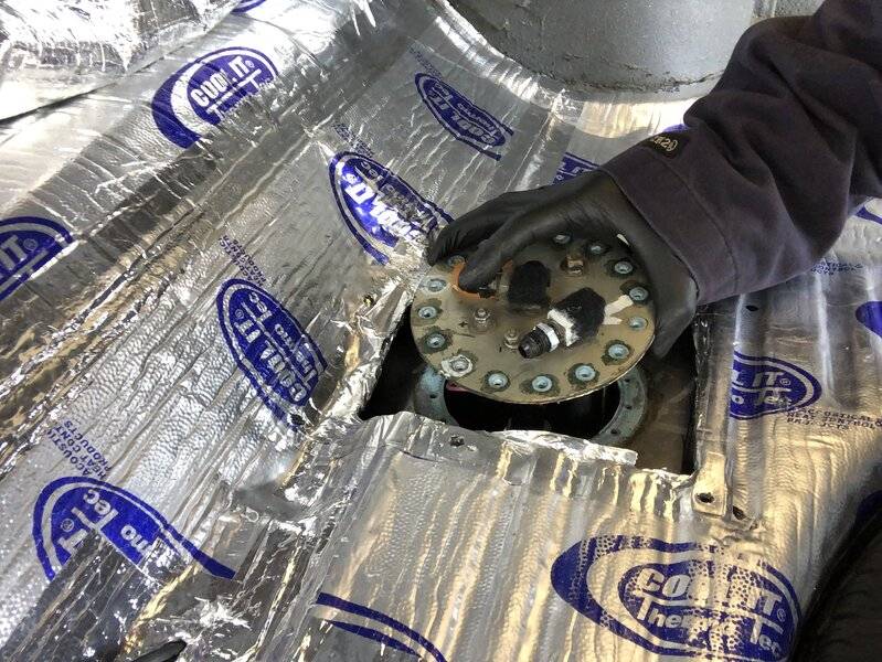

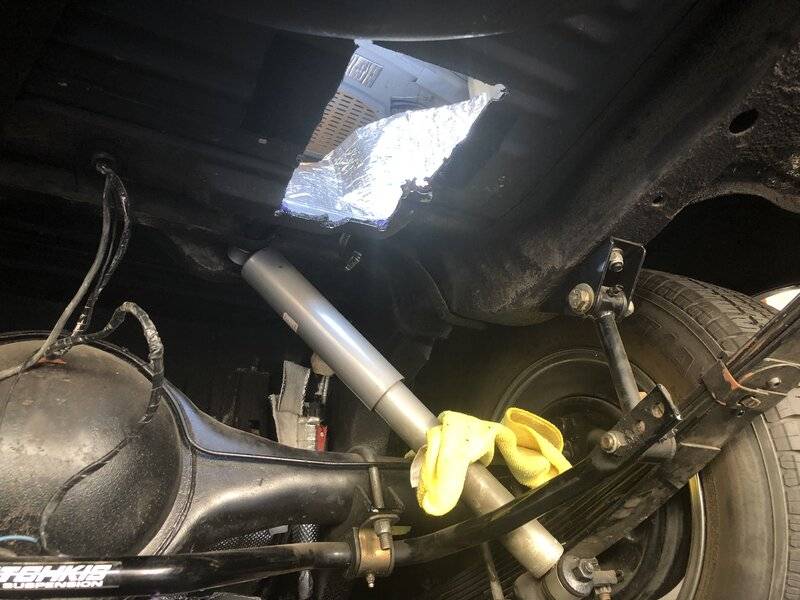

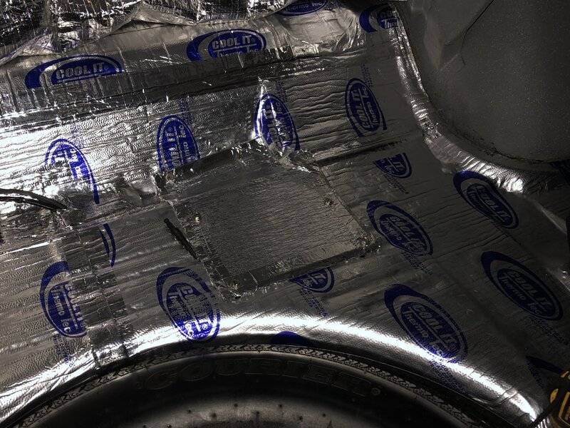

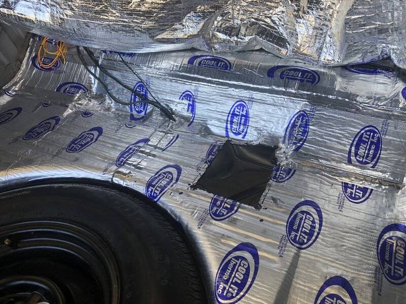

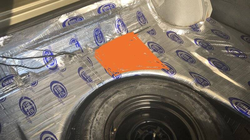

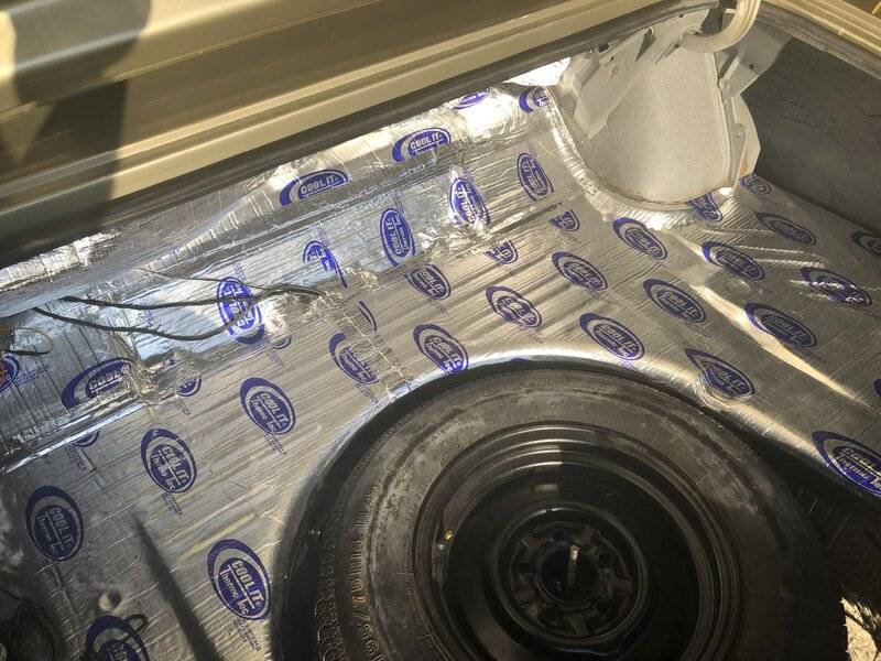

the pic shows the area where i plan to do the cutout. it may not need be that big. will need to get tank out and refresh my memory on what it looks like
and like magic the trunk floor opened up

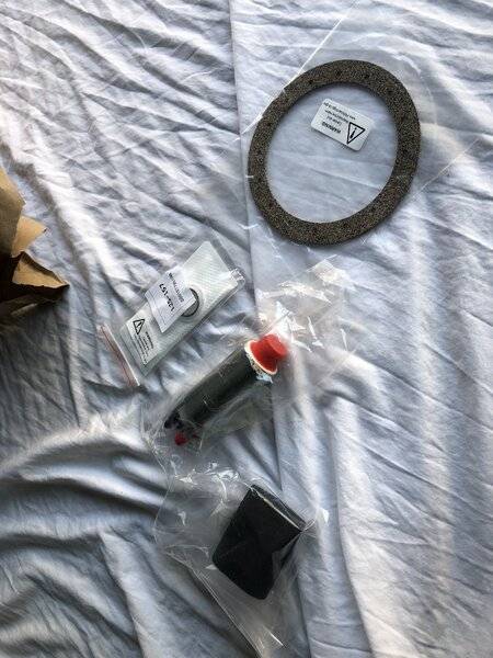

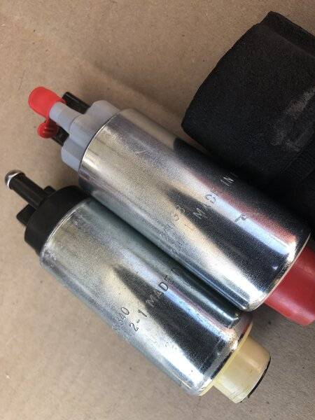

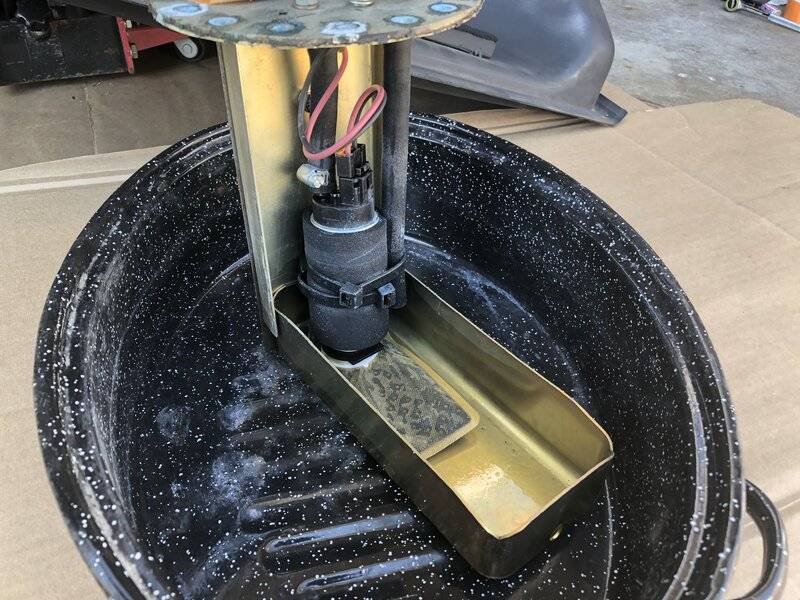

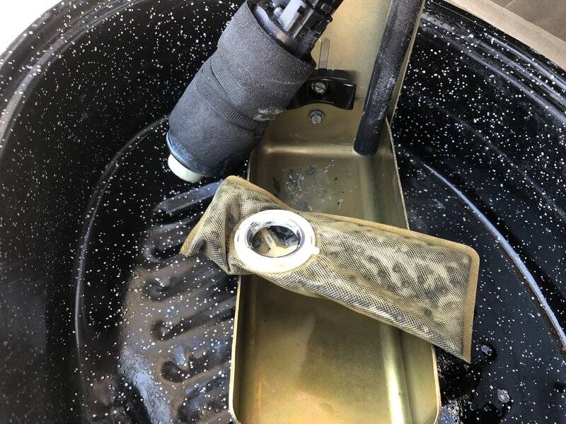

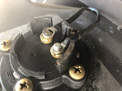

some random pics of the original in-tank fuel assembly coming out - i think the only problem was i was low on gas....oooopppps
the little dog can’t believe it either. i went ahead and tossed in the new pump anyhow

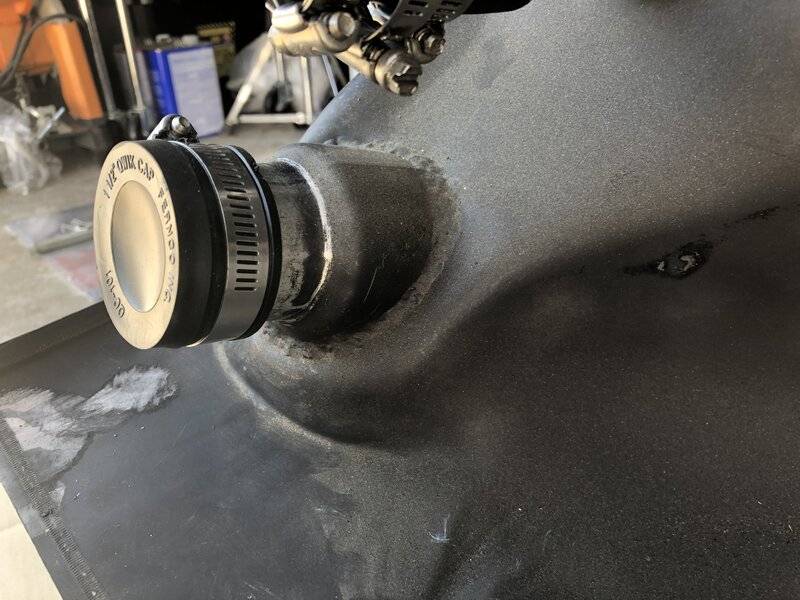

other pics of my modified gas tank. i figured i share them with you all because i haven’t seen it in a while either.

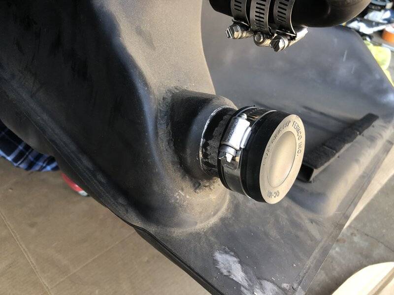

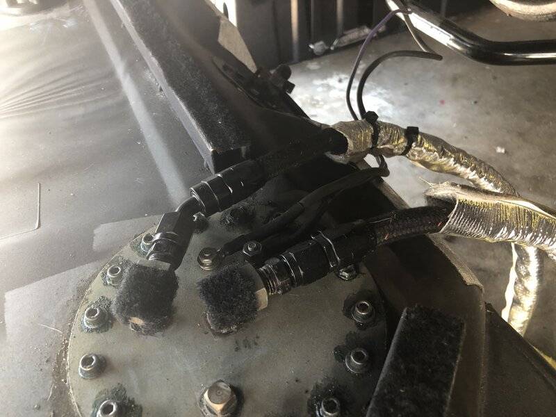

when the MSD Atomic EFI went in i modified the area where the fuel neck entered the tank

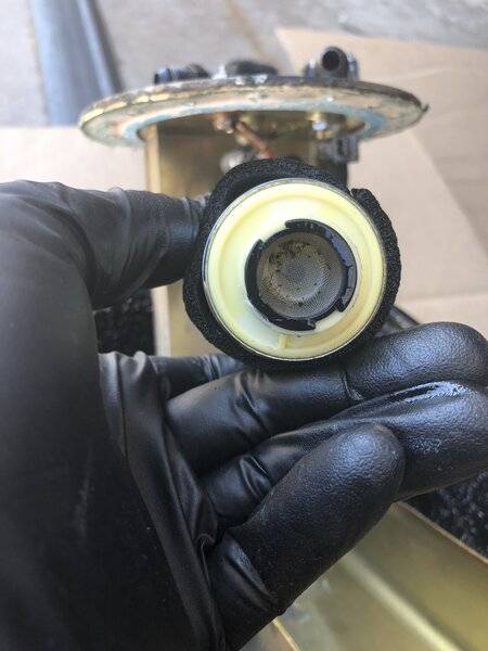

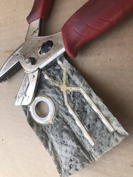

the pump and prefilter were good - a few small specks all caught in the sock and post sock area

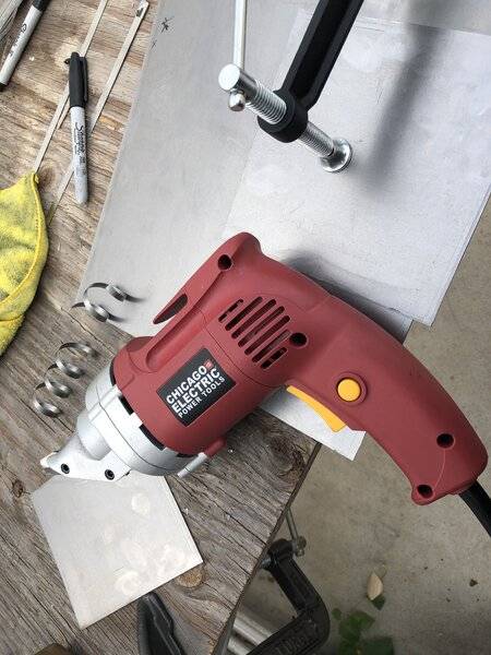

found another great tool at Harbor Freight for the shed - the metal cutter. i would have normally futzed with the snips and angle grinder cutoff wheel but no more

Metal shears?
We use something like those for cutting cement board siding to reduce airborne dust.

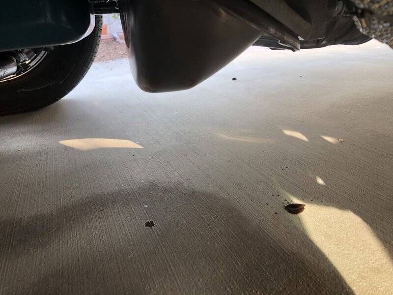

got it filled up this morn and was double checking things. it appears i definitely have a rear main seal leak or oil pan issue of a healthy proportion. engine oil is a dripping.

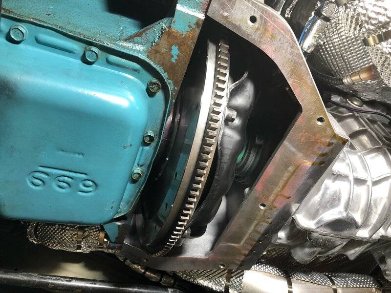

i really don’t want to get back under there. would rather take it for an actual test drive. will pull off tko500 inpesction cover and take a look.
watermelon
ordered a fastfish rear main seal for the 440 but i dont think i need it
looking at the crank flange area between for signs of oil i dont see any. nothing on the flywheel either. no oil on the backs of cylinder heads or oil pressure interface on the block. my thought is maybe somewhere around the rear pan and rear block area there is a leak and it spits out oil as the pressure in the engine builds
maybe i just need toss on a new oil pan gasket and oil pan

Watermelon, wait! Before you just throw parts at the situation you need to know the root cause. You need to find the source of that oil leak first, because it'll only frustrate you more if you go through all the work of replacing the pan gasket only to find out when you put it all back together that you still haven't fixed it!
You might then start thinking about some terrible thoughts like.. selling the car!
Let's go through some diagnoses steps to pinpoint the source of your problem....
I too had an annoying leak just like that and it drove me nuts before I found the source. I got ideas from others on the FBBO forum that helped me find & fix it.
If your leak only shows after the vehicle has been running that generally means it's above the static oil level in the sump. I'm 100% sure but I think that's below the oil pan gasket & maybe a the rear seal. That means that the oil needs to sloshed around above the static level and or the crankcase needs to be pressurized in order for the leak to occur.
Adequate oil sloshing isn't feasible to recreate w/o the engine running , but crankcase pressure is!
Try this but use extreme caution!!
Using a very small amount (~5psi) of compressed air from your compressor, fabricate an air line with an on/off lever that can go into a hole already in your valve cover. Temporarily seal off the other holes (vacuum, PVC & oil fill) on both valve covers. Create a soapy water mix in a spray bottle. Turn on the air pressure & let it stabilize first, then insert the airline into the valve cover. Immediately start listening & spraying oil sealing gaskets for leaks. Get under the car and spray around the oil pan and rear seal areas. Bubbles will reveal your leak source.
This will only take a small amount of air pressure to work but may take a minute or so to build up pressure in the CC. Turn off the air after 2-3 minutes as not to over pressurize the CC and risk blowing out an oil seal.
The soapy water mix might cause flash rust on non painted surfaces when it dries.
