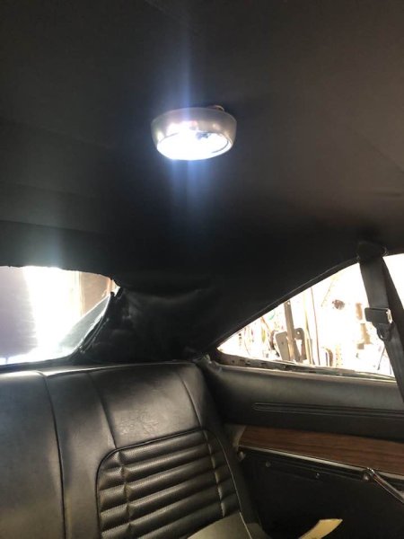

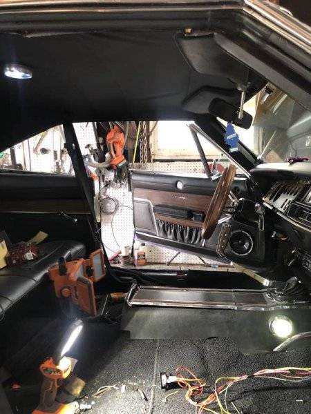

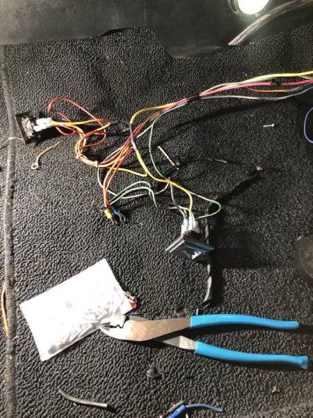

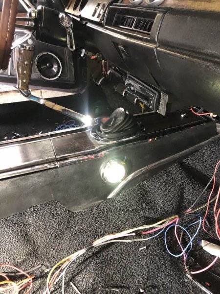

Spent a couple hours today wiring up the center console, dome light, and the power windows. The reverse lights and the clutch safety switch are installed. Tomorrow I am going to let the car down and fire it up! Test drive to follow. Hours today 5. Total running - 45 hours for the Tremec 5 speed conversion in a 1970 Charger 500 SE.
I'm curious about your clutch safety switch. How and where is it installed.
