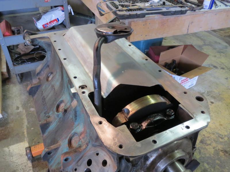

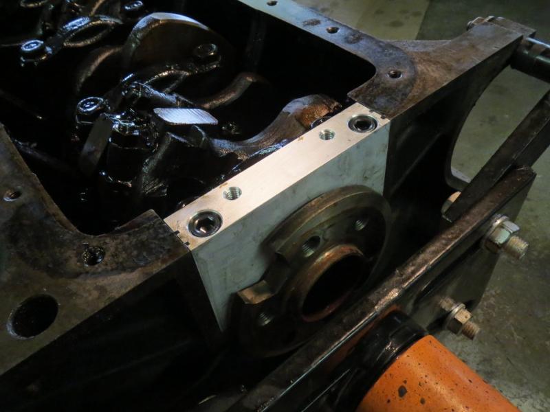

I just installed a wind age tray on the 440 in my Imperial and the billet aluminum rear main seal housing from Mancinis, hopefully that takes care of my leaky rear main.
