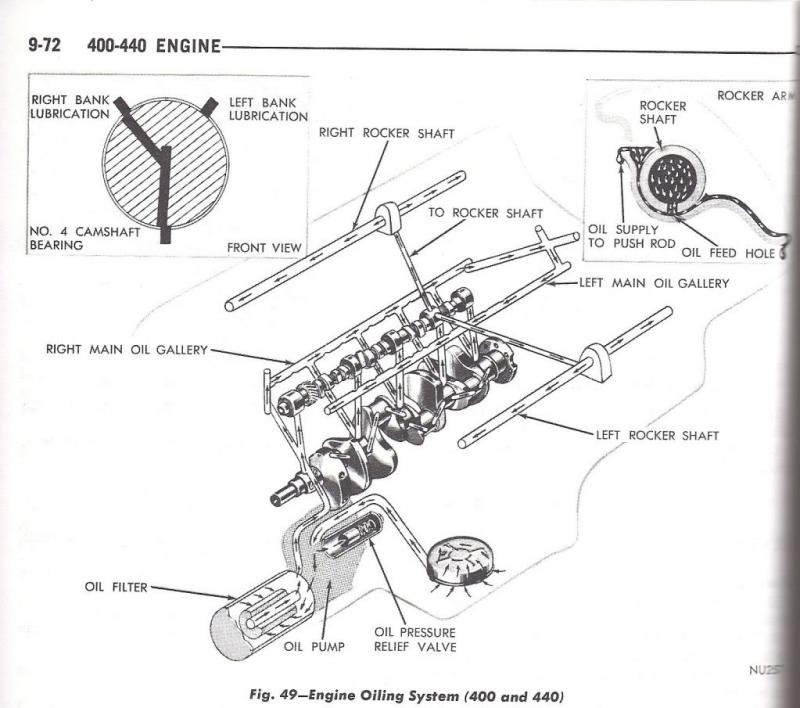

I would be more worried about loosing oil to ALL of the main bearings and even more on #4 cam bearing. Many performance engine builds (including my own) have restrictors placed into the rocker shaft supply circuits in the block. This is done to keep the needed oil at the #4 cam bearing and #'s 4&5 main bearings. If your using roller tip rockers this reduces the oil needed even more at the top end.
this is a diagram for you to follow..
