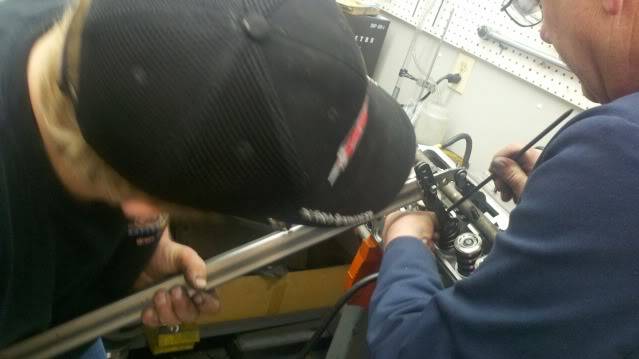

Here's a couple of pics of tool we used to change springs with the heads on.
Enjoy.

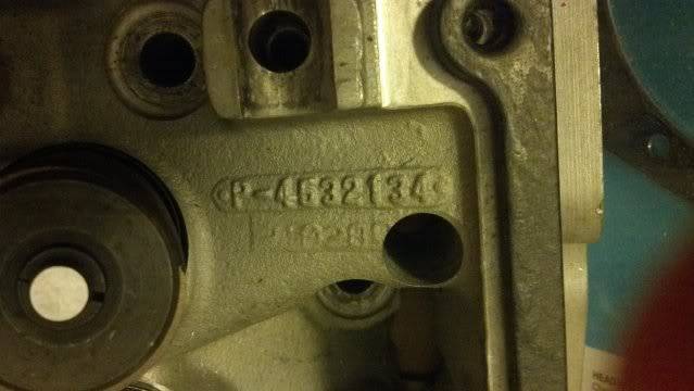

Thats the Stage 6 heads part #.

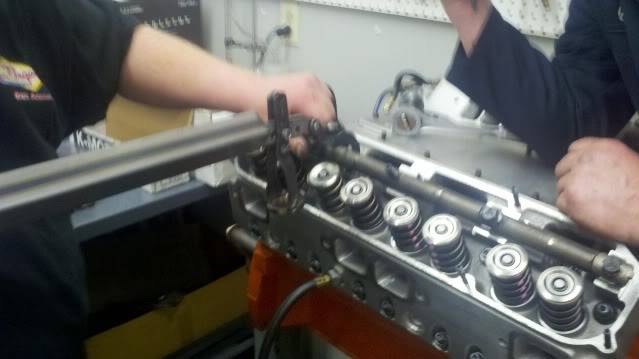

Here's what the first pic should have been.
The jaws on the rail go over the retainer.

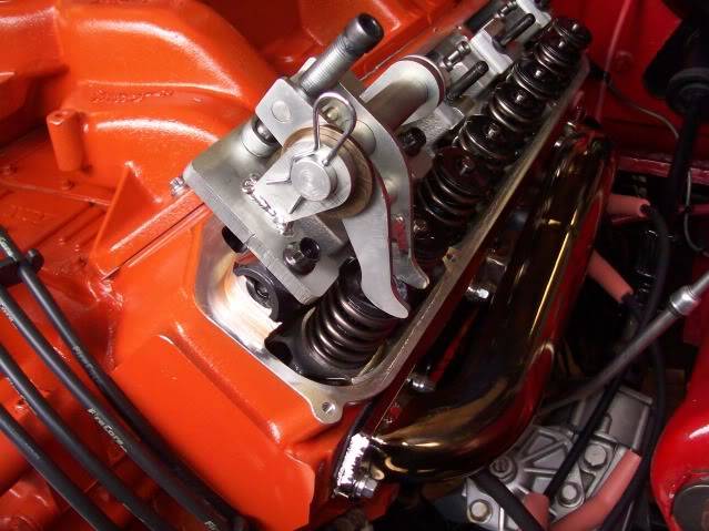

check mancini's they have them with a bolt to compress the spring.Easier one person use!You will pay 2 bills though for one.Well worth the money.
Holly Batcrap Batman, womanator that's one hell of a spring compression lever....
I bought this from Mancini's and it works great. Should do the job. Ron

Thats the tool I am talking about!I have a air operated head off spring compressor very spoiled there.For the heads on spring compressor had a similar tool made up by a machinist friend.It was not so finger friendly when you dont slip the bar on correctly!!:fit:
The mancini tool sound good.
