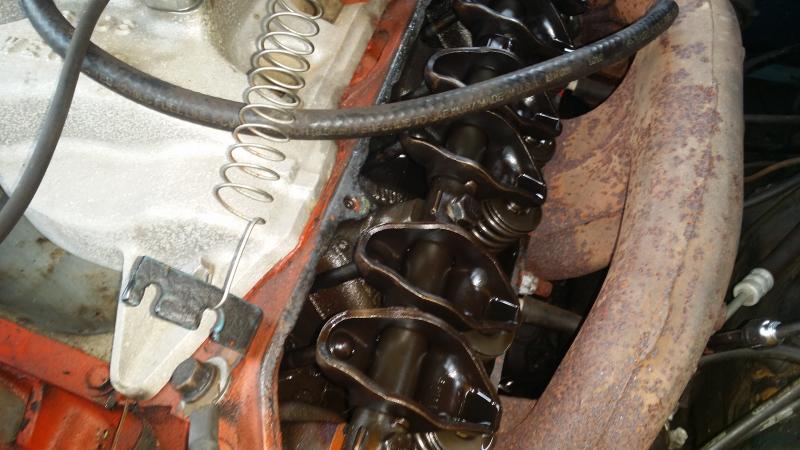

Anyway it seemed like the drivers side head. Pulled the cover to find they are stock 452 heads. Except for the cylinder under pressure, they all have very little play. It's raining here and I don't have a covered spot to work so I covered the exposed head and will try to mess with it later.

Did find our the manifolds are Hp with a 900 on one side and a 865 on the other... Weird.
Good to see you got to this point. Next step, isolate it to the noisy rocker (s). You may want to pull the rocker shaft off, and lay each pushrod on a hard flat smooth surface, such as the dining room table. Lol. Roll them along to see if any are bent.
