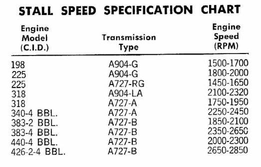

From the 1970 shop manual, even conservative factory ratings gave the 383 a lot more than 2,000 stall.
My 1st mind told me to go with a 2400 stall but the novice in me told me to ask the engine builders that also race cars etc so I took their advice. I purchased the converter around the same time I got my engine out of the shop which was summer of 2015 so the warranty has expired.
