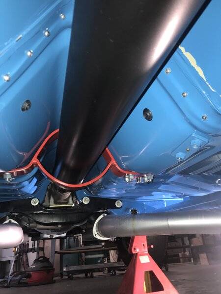

Here is an option I like & need to install:
http://www.manciniracing.com/bofrdrlo.html
I have that on my 70 440+6bbl manual transmission Roadrunner AND after a LOT of shopping and comparisons, STRANGE ENGINEERING by FAR had the best price for a chromoly steel driveshaft and slip yoke with 1350 solid U-joints!
I am so impressed with Strange price, quality, strength, and tech support, as well as production time, I got American Powertrain to refund our credit they held for a driveshaft from them, as part of a TKO600 transmission package, so I could apply that to a Strange driveshaft!
If you are interested, start here:
https://www.strangeengineering.net/...ome-moly-driveshaft-with-h-d-u-joints-2.html/
Take a look at USCartool's DS loop...theirs bolts onto the crossmember... nice unit.

Here if you do an 20% increase in motor power driveshaft hoop is compulsory. and depending on set up more than one, Seeing this I'm gals as the 318 is coming out later in the year and 440 going in, funny thing if the car is original 440 it doesnt need one
