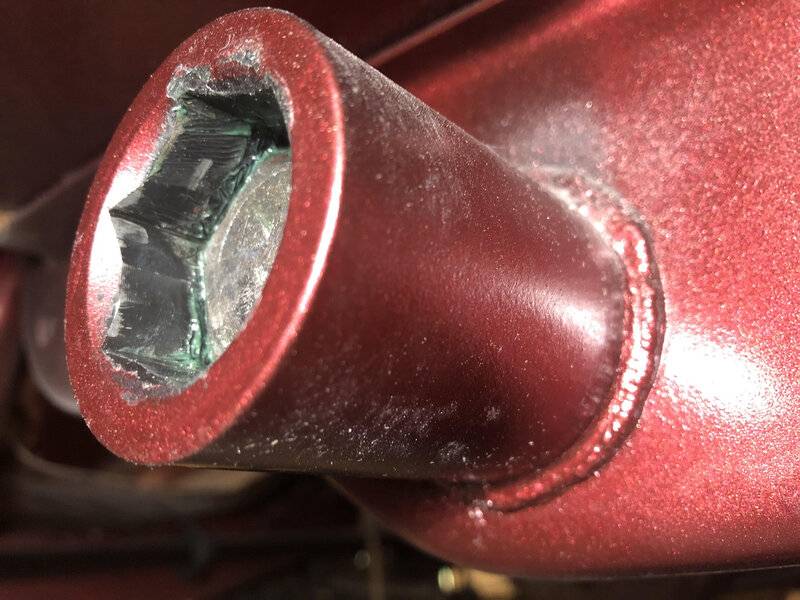

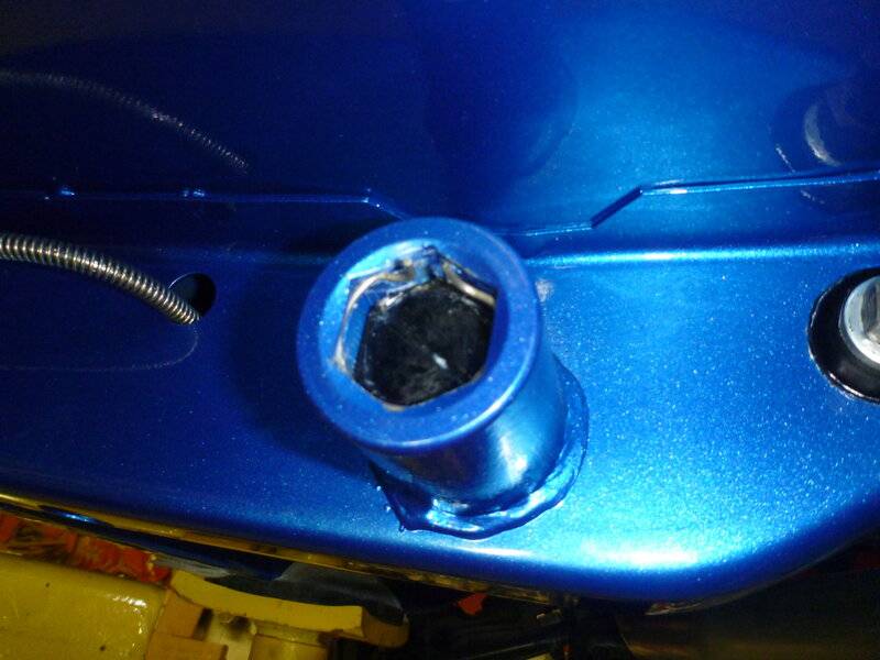

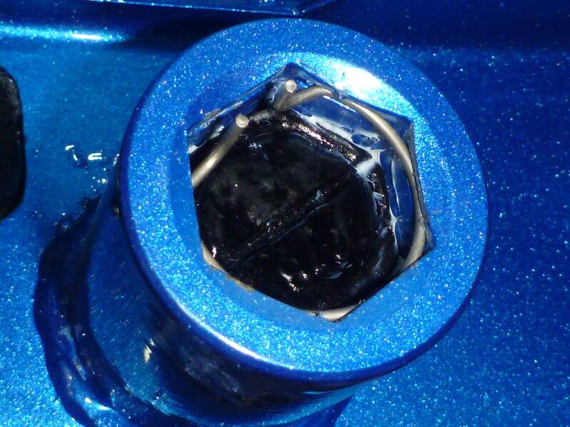

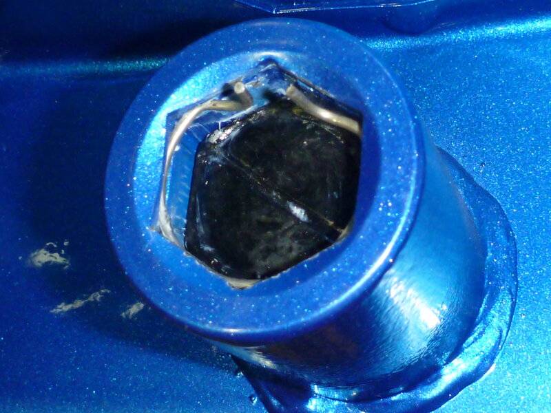

Hi, I was wondering if anybody knows about how deep into the back of the torsion bar cross member the retainer clip groove is located? I replaced the cross member a couple years ago and just got the new suspension in last weekend. I went to put the clips in and I couldn't find the groove. I pushed the torsion bars as far in as they would go and still no sign of the groove. The torsion bars are now recessed a half inch in to the cross member. Is it possible that my less than reputable brand cross member just doesn't have a groove in it for the clips? If so can I just put a groove in with a dremel?

Looks like I can JUST see a grove in there, but that's definitely too deep!
I thought that was a groove too but I stuck a pic in it and it's just how the grease is laying. I stuck the pic back in there and couldn't find anything resembling a groove.

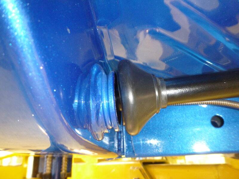

Nah, that piece that sticks out is only on the back. The front is just long enough for the dust boot to slip on. I think it's because I decided to save money and not buy the more expensive AMD cross member.
