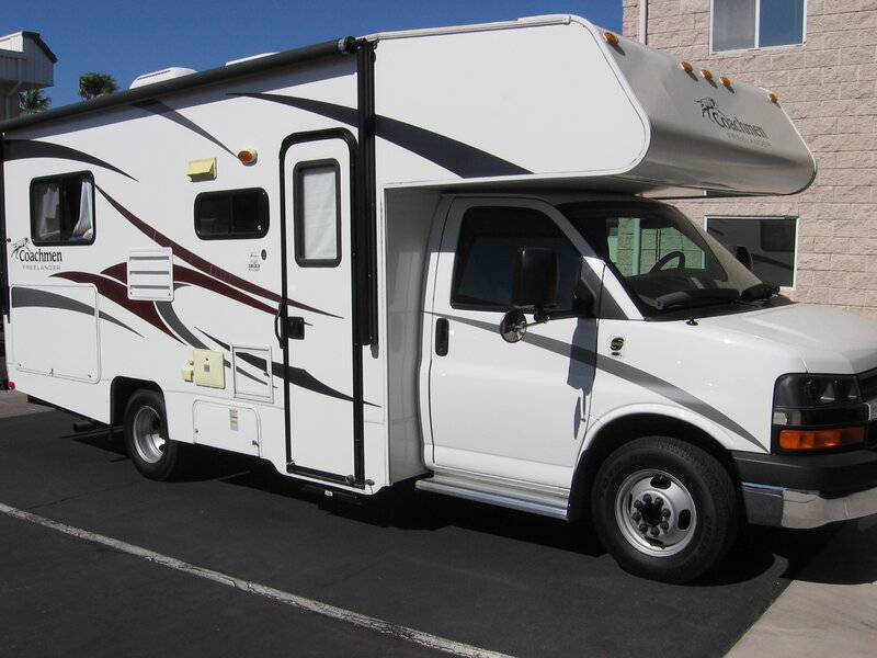

Right now I have a 2010 Coachman Freelander 6 LTR(364 CI) Gas. It too gets 6 MPG towing.Up-graded to a class 5 hitch,Timbren helper springs to keep it level and have at least 20,000 miles towing the same trailer.
Trailer gross weight is between 6500-7000.

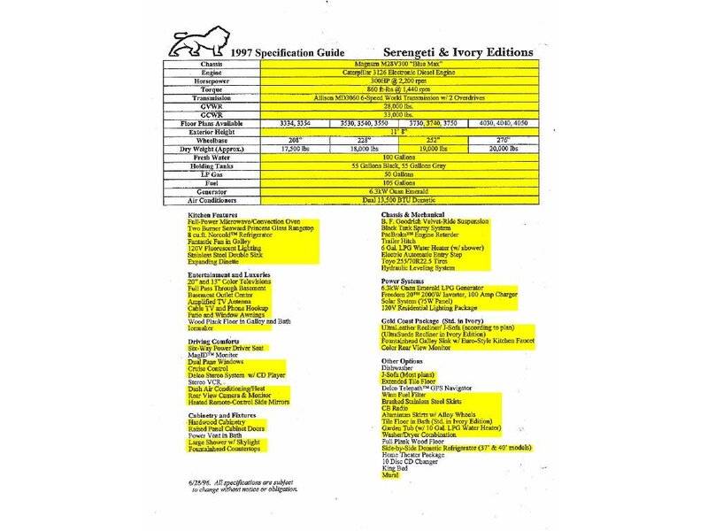

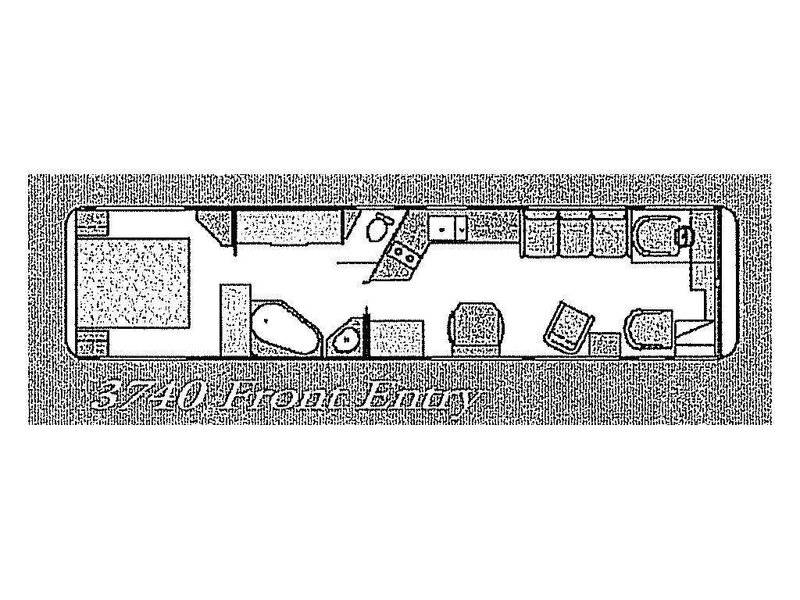

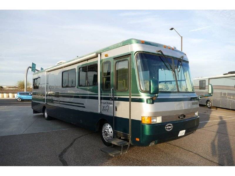

I towed some 140k miles with this below
97 Safari, Magnum Chassis diesel pusher 36'
5.9 Cummins Turbo diesel/Allison 5 speed
I got it used for $100k out the door, when it was less than 2 years old
Org sale price was $180k
plenty of power, plenty of towing capabilities
I towed a Featherlite 36' tri-axle 2 car stacked trailer (inc. the tongue)
It was like sitting on my recliner driving down the road
great views too
IMO only drawback is it's a flat-tow, but sufficient
