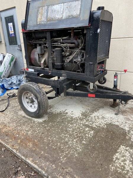

Does seem as thought that the trailer should be longer.
Just for maneuvering alone the tung length is way short. Is that angle iron hanging down that the tung is welded to... sketchy looking? I don't get the layers of box stacked up that makes it so tall either? I'd honestly start over, it would be easier. 2×4 box frame that the leafs and welder bolt directly to without the layers and a longer tung.To me this trailer looks like its made wrong. Its to short, load is close to hitch. It looks like it was made for a machine half the size.
The biggest thing I feel is the hitch is to low. I have a Tacoma 4x4 and its still seems to low for that truck....It feels like the more you raise it up past being level it wants to flip over backwards.
Notice it has a jack in the rear
That trailer looks a bit top-heavy for the length of drawbar and axle width. I would not be keen to tow that at anything above 40mph.
I knew it was wrong and thanks for the replyJust for maneuvering alone the tung length is way short. Is that angle iron hanging down that the tung is welded to... sketchy looking? I don't get the layers of box stacked up that makes it so tall either? I'd honestly start over, it would be easier. 2×4 box frame that the leafs and welder bolt directly to without the layers and a longer tung.
It’s junk except for what I can salvageHmm, I see your point...Perhaps like some of the guys mentioned, 60% over the axle?
I talked to the guy who built it tonight, said he built it with his dad....What could I say,,,why he made it so high, such a short tongue....My thoughts were towing it down my daughters house for storage....Its a hundred miles away and down I 95.....No way id do that with this trailer.... Like I said I didnt buy it for the trailer but I wish I could have at least modified the trailer to work, now im keeping the axel, springs and wheels and scraping the rest and starting from scratch ....Your right on the money with your advise and thanks747mopar idea on the frame is spot-on. Your current set-up is way too short and top-heavy to be a safe pull over 30 mph, IMO. Double the frame length, lower the assembly, and adjust the weight bias fore/aft to 60/40. You'll then be able to haul that with minimum issues. Throw some fenders and lighting/reflectors on it. Good luck!
