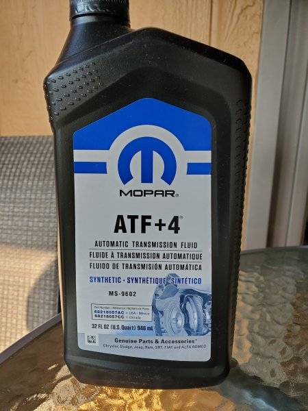

Kind of off topic here, but what fluid came in, or is used in '05 Ram Cummins Autos ? Did they come from Factory with the Synthetic ATF+4 ? I've been wanting to add a deeper pan, so I'd like to match the fluid on the change...
Yes, the ATF+4 is factory for the 2005 48RE transmission.
My 2005 Ram 3500 has the large ATS trans pan, and draining the fluid will almost fill a 5-gallon bucket.
Type of fluid- any, except type F.
