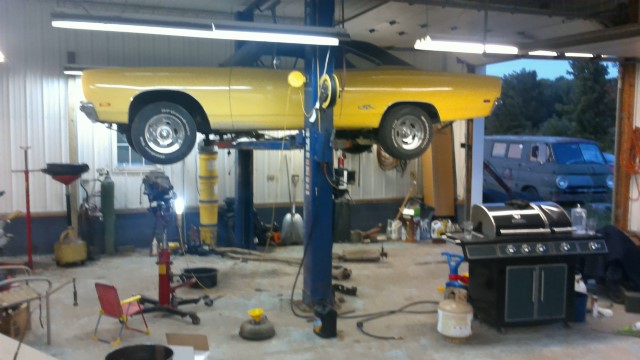

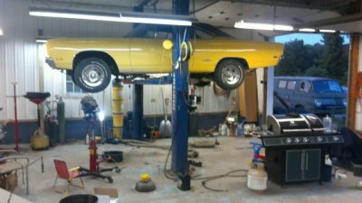

So we threw it on the lift, called a friend of ours who's got a few extra hurst mechanisms just laying around, and throw one of em in the car.
The feel of the lever is loose, very loose between gears, but still have to fight it into gears. With the car on the lift we sit there running it through the gears with the car off and it feels,...meh...
Start the car up and the mehhh goes to nothing but free floating shifter lever, sometimes it would act like I could get it into gear, but the odd part is the car will not go into neutral even with the lever free, and in neutral. After messing around for about an hour we just gave up without saying a word. We have no idea what to do next.

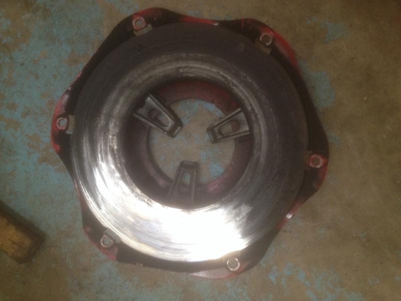

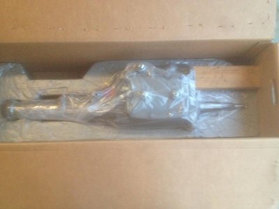

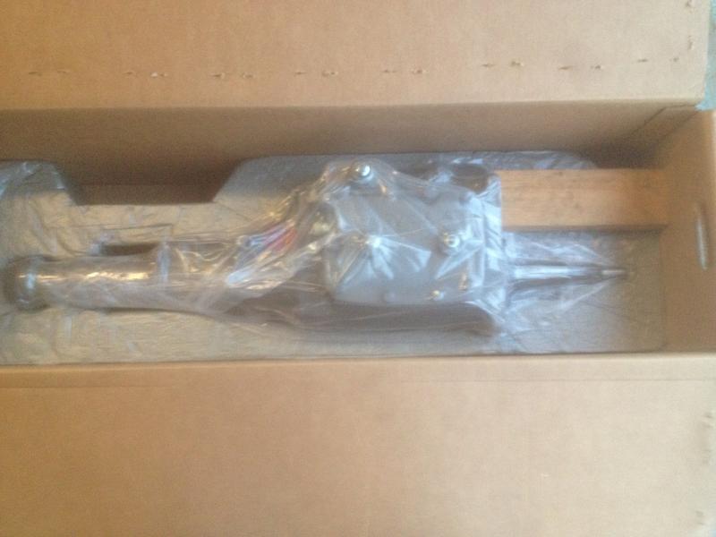

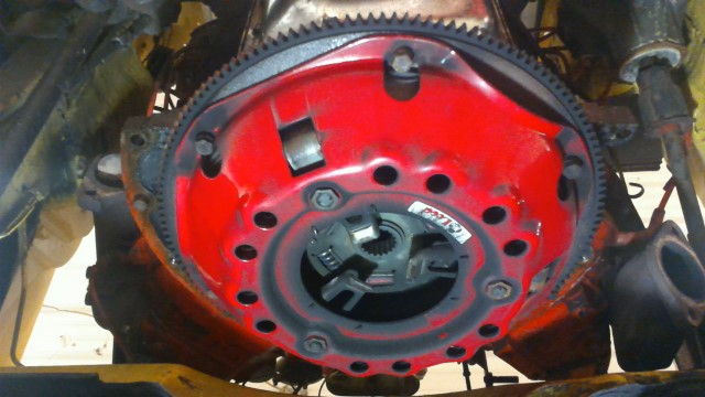

So its been a while since I've made it to the site... I know 62dc had asked me a while ago to keep this post updated, so heres what happened. The car sat all last summer, and all of this summer. A few months ago I got into tearing the tranny out, and gave it to brewers performance for a full rebuild. I previously purchased my clutch through them and they were very helpful to me in the past.

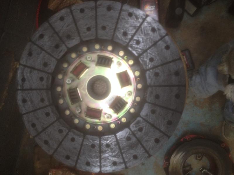

And you were right - there were many things wrong, my main case had a 3inch crack, it needed all new syncros, shift forks and levers, and other misc things. Got the tranny back with a new case and she looks brand new. They also sent my clutch back to McLeod for me, there were problems with that too. One of the pp springs was busted, and you could see on the plate where it wasn't fully contacting the whole circumference. No questions were asked, and within a month my clutch was returned to me rebuilt at no charge. Couldn't be happier with the service I got from brewers, I can't wait to get it all back together.

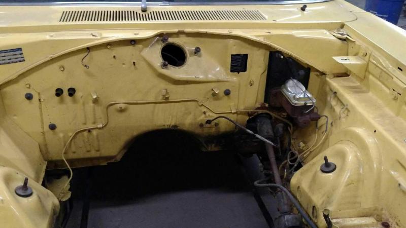

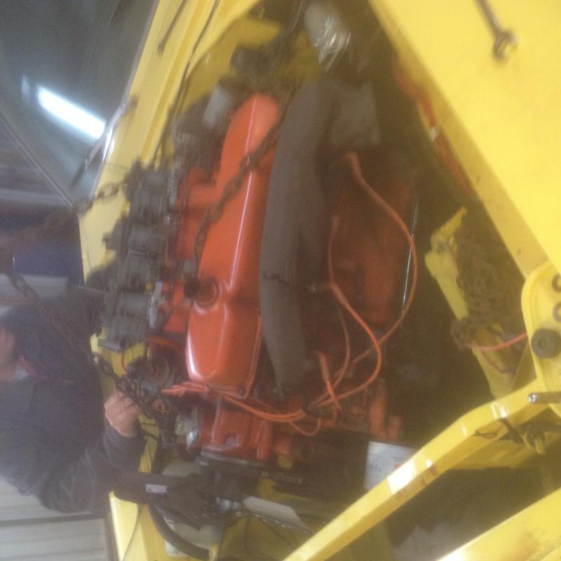

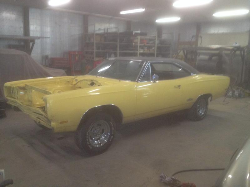

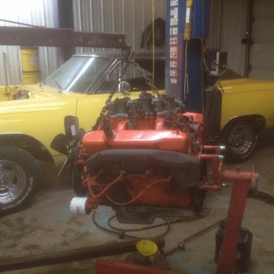

I also yanked the motor to go through and rebuild, and the car is currently at a friend of mines for body work. I'm working on hoarding new parts for it this winter so I can finish it and get back on the road come springtime.
