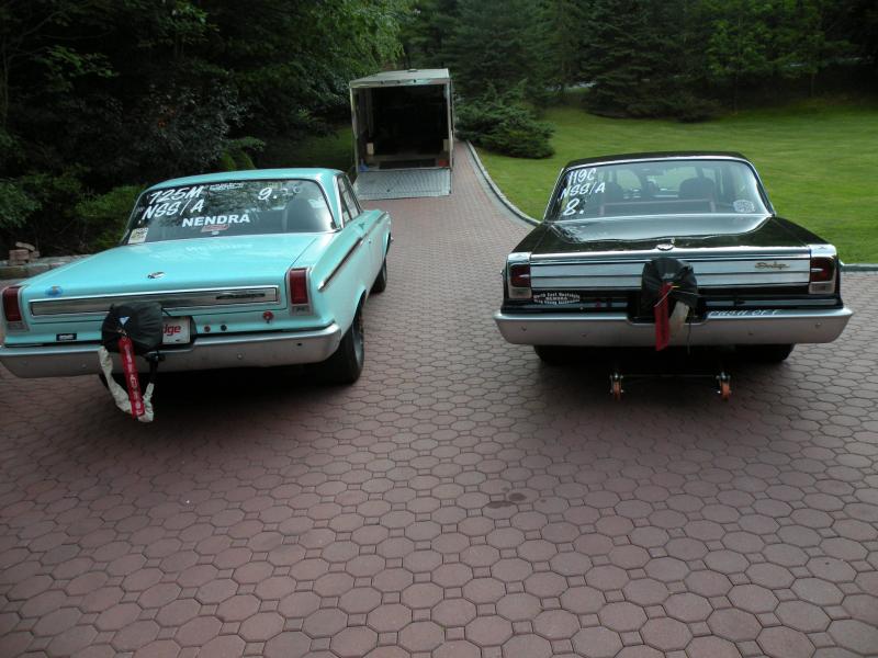

you thought wrong. mine never push through.
