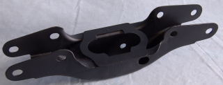

Anybody have a picture of the 4 speed crossmember? Shouldn't be all that hard to revamp an automatic crossmember into a 4 speed one. FSM does not show one that I can find.

not the best pic, but here's a look-

HitIt comes through again. From what I can see, it looks like the basic crossmember is the same, just the very top where it is closest to the trans, is different. I wonder about the shape on the very bottom. the automatic is fairly round. I would think that the 4 speed would be flatter in order to accomidate the mount. If I knew how far above the crossmember that the trans mount is, I could easily re-engineer the automatic crossmember.
Finished the trans mount. Actually pretty easy. I used a cutoff wheel to remove the automatic trans "extension" as well as rhe flat plate on top of the crossmember. I then drilled the bottom of the mount for the one 5/16-18 trans mount bolt (1968 mount). One access hole was already in place on the bottom of the crossmember, but it did have do be increased in size to accomodate a 5/8" socket (for the trans bolts). The other side had to be drilled as there was no hole. The '68 mount works on my later model trans but the bolt spacing is closer than the early trans.
Thanks to everyone for their help and advice.
