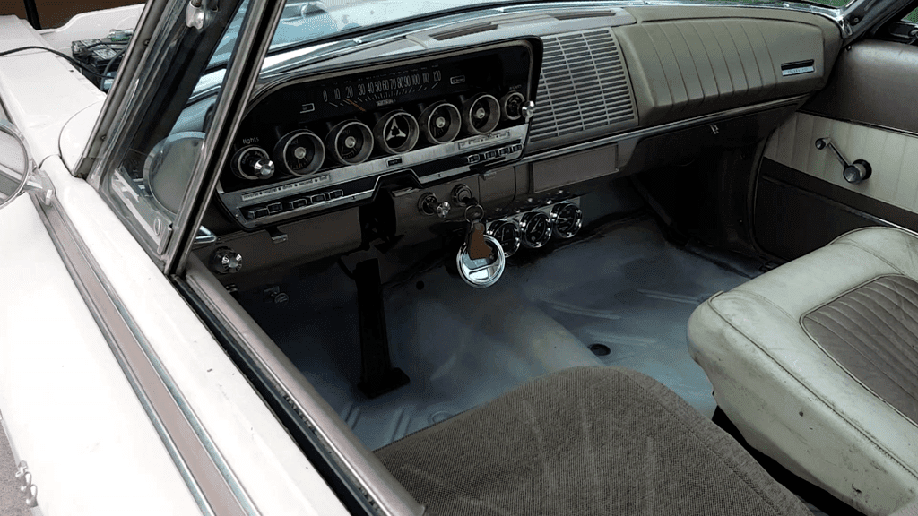

1962 Dodge Original Push Button Torqueflight
Spent the last couple of weeks getting this car off the jack stands, pushed it outside today, hoping to try out the trans and running gear and nothing!
Here I am trying "drive" to "reverse" to "neutral" back to "drive" ect. Nothing, not even a grunt!

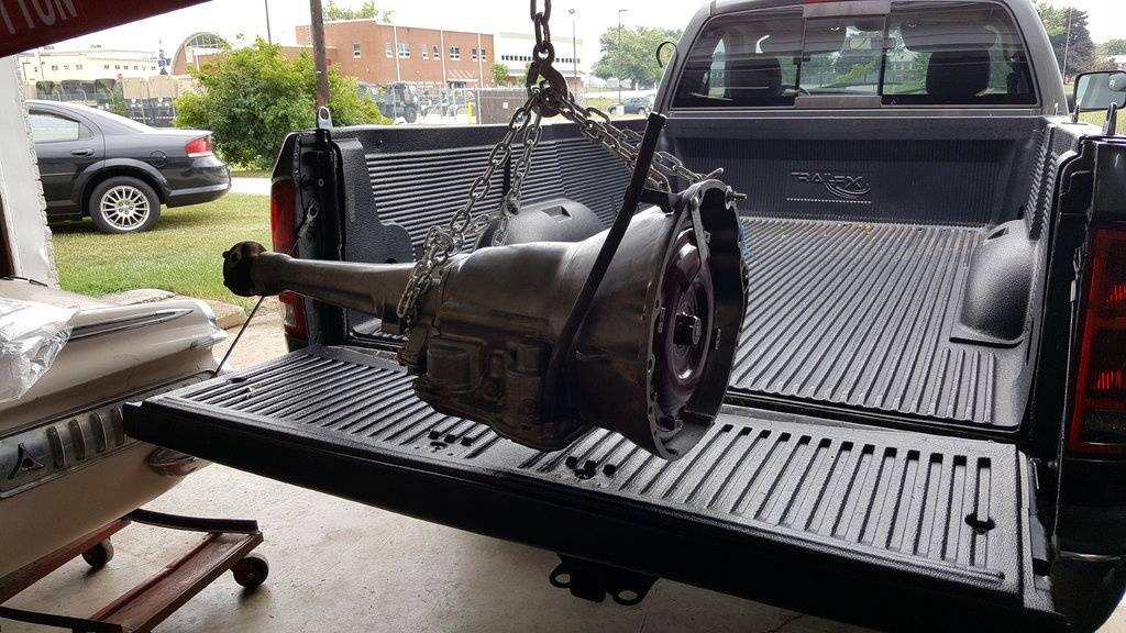

Well at least---these don't come back out!
No flow threw the filter or a valve did not get put back in the valve body correctly. Some thing i have done myself and took some time in the library to remedy. Load it on the trailer and take it to him. I really doubt he takes the trans out.

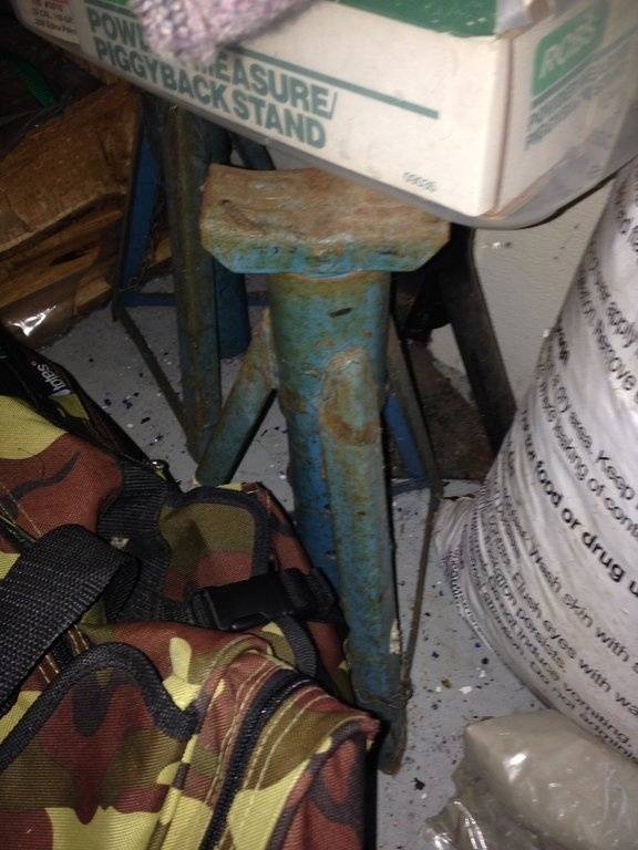

Bee there is NO way in hell I'd get under a car with those JS's.
Kinda off- topic but these don't bother me, they've held multiple times; I remember duck-walking under railroad type with 2"(?) air lines feeding them to hold up semi-trailers. Mine are well used/tested. Thanks for the thoughts though, usually it's a pair with 2ton hyd jack at any one end.
