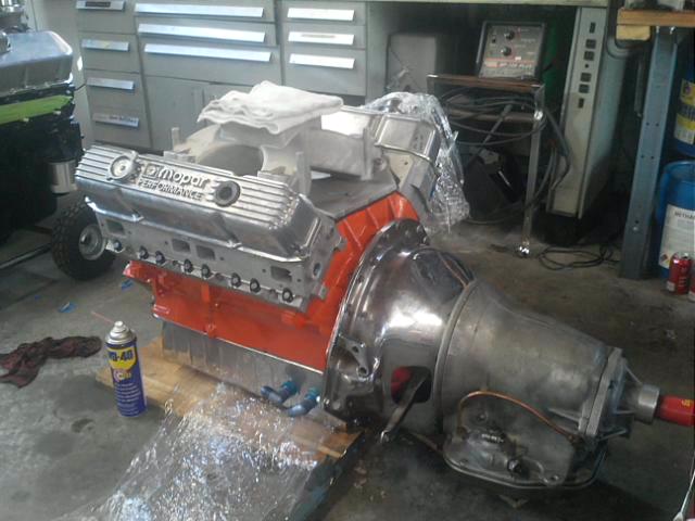

I see Moroso makes a pan for te 727 with 2 drain plugs - one of which can be used for a temperature sending unit, plus it holds an additional quart of fluid, I believe.
Clutchflights are cool.
Converter outlet temp is a function of converter slippage vs time. Sit on the converter long enough and it'll send the trans temp to the moon. What you want to know is if the cooler can get the fluid temp back to a usable range for the trans to function correctly. That would be pan temp.
