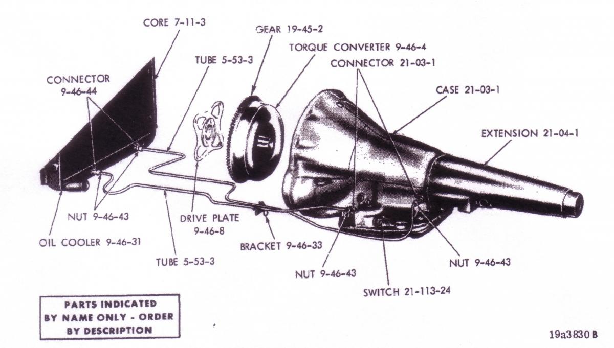

hey i was wondering which line on the 727 torque flight is the supply and which one is the return. adding another tranny cooler. is the front line off the tranny the supply or return. thanks guys
supply from the tranny to the radiator. which line off the transmission is the supply and return. the front line off the tranny is the supply what 65 440 said i just want to be sure.
:edgy: It's been awhile. You could take the lines loose, crank it without the coil wire, you'll find out... I think 440 is correct :)
its the front port,trust me ! i just went through this routing my braided hose to my new cooler !!
