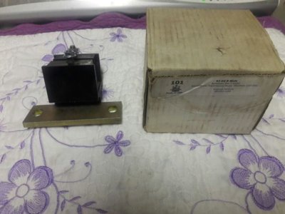

hi this is a new piece from imperial services I paid 88$ make an offer plus shipping thanks
