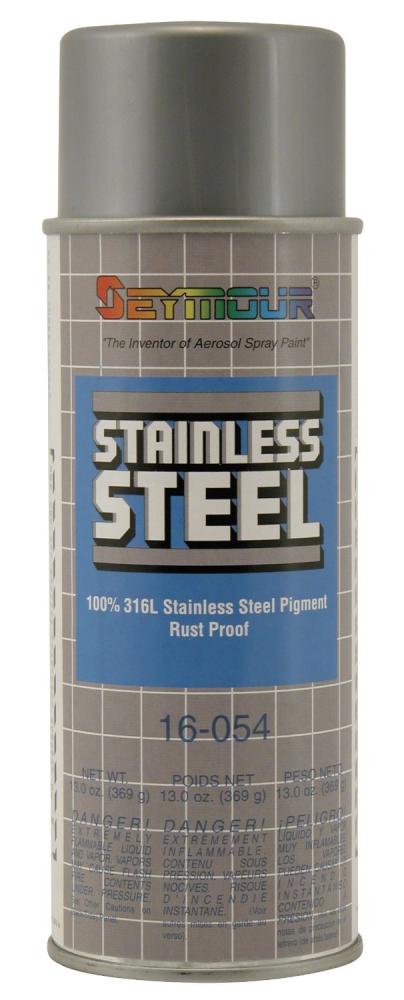

This paint is about $6.00- $7.00 / can. It looks absolutely beautifull on leaf springs,
brake drums, lower control arms, etc. It will make the trans look great, and make it easy to wipe-down!

Similar to an intake manifold, clearcoat will yellow and look terrible in no time. The heat is not friendly to clear.
The stainless pigment should be available at your local jobber. If not ask if they can order it for you.
That's the silver the degenerates buy and blow there brains out on.... so it's got to be rugged stuff. Great tip... and lock it up so you don't get broken into for it.

I cleaned and/or blasted the shifter levers along with some other hardware and coated them with RPM (Rust Prevention Magic) about $35 from Amazon. You heat the hardware with a gun, hair dryer or put them in the oven at 300ish. When warm to hot you paint this stuff on. High sheen initially then dries to a little darker natural finish. I did one lever without blasting and just cleaned in well with a brush, carb cleaner and sandpaper and it looks a bit more older and more natural for a 44 year old car. I may try that stainless steel spray on some other parts.

Sorry I took so long to reply. I live in Northern Illinois, and I took a ride out to DeKalb Il., to "The Parts Place" and bought six cans for what I needed.
They ship I believe, but it is considered a hazMat so good luck. The company that makes it is also in Illinois, but they do not sell to the public.
