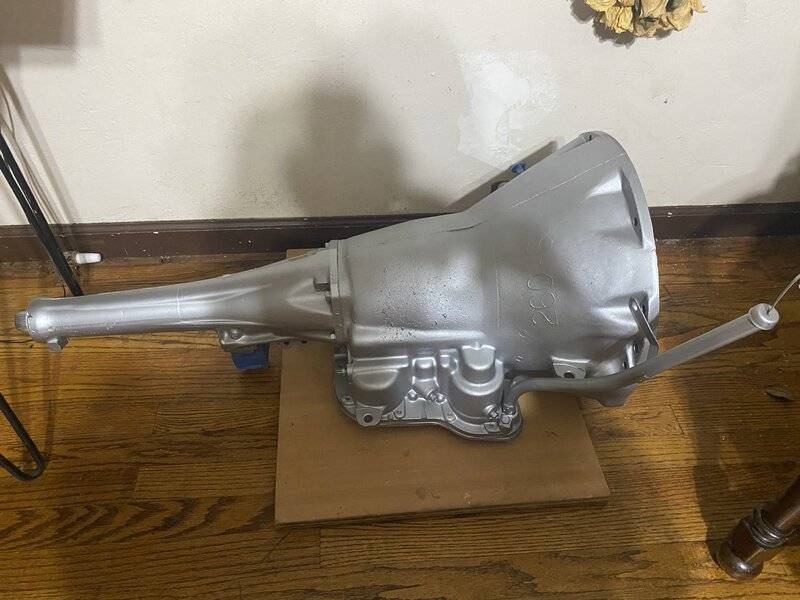

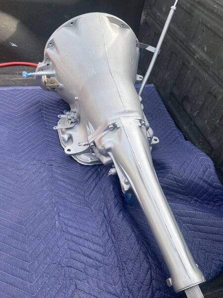

Happy because I have been driving my car finally. But frustrated with the transmission. The car is a 1967 Coronet with a 318 and 727 automatic transmission. I have spent 15 months working on the car mechanically and it sounds great. Last phase was taking out the transmission to change all seals because it was leaking badly. Good new is it no longer leaks at all.
It seems like when I take short trips, say 5 to 7 miles the transmission shifts great. However if I try to take it on a long trip upwards of 10 miles I start having shifting issues. Then if the car sits overnight the next short drive is good again. Todays drive was about 16 miles and a third into the drive my transmission would not shift past second it seemed. At a light when accelerating the car would move and I could feel it shift into second but then would feel forced and not shift past that. I drove for about a mile and a half really slow. Then I began shifting it myself. I am assuming the 1 and 2 on the steering column gear selector refer to first and second gear? Please correct me if I am wrong. I have checked the fluid level and triple checked the kickdown linkage. What I don’t understand is why the shifting issues start after driving a while. Please help, this is the only issue remaining before I feel confident in taking long cruises.

I would suspect governor circuit leakage or blockage. Does it just not shift into 3rd or does the engine race when it shifts as in neutral?
The filter was changed last month and all fluid was drained and replaced. I also replaced the torque converter with a new one from rock auto. Not sure i understand the race when it shifts as in neutral question. It feels as if it never shifts to third because the car will not go any faster even if I push on the pedal.
When the trans won't shift into high gear how is reverse? If reverse is also "soft"...
The front clutch seals are probably leaking & not allowing the clutch to apply...
I drove it earlier to the grocery store and reversed it out of my driveway and it all seemed fine. But yes, when I was having issues this afternoon I did notice I had to really press on the pedal to get it to go one reverse.
As I am researching this issue in the internet I keep coming across front and rear band adjustment recommendations. Could this have something to do with it?
