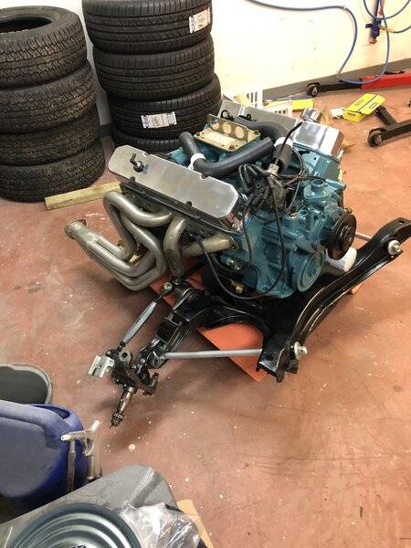

Hey folks I recently installed my 440 and 4 speed back in my 68 charger (together from the bottom). I am using poly lock mounts on the engine and polyurethane on the transmission, everything went in great except for the transmission tail shaft is shifted hard to the passenger’s side for some reason. Everything fits fine engine side, even the shifter a bar but it isn’t right somehow, any ideas??? I am trying not to get violent with it since I have fresh paint underneath

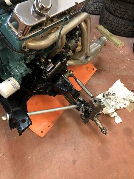

I will get some pictures later this week, I think the mounts are installed properly but I will definitely back them off and wiggle everything. I have pics of the motor installed on the k frame.
