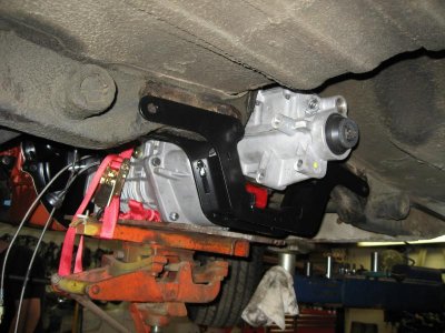

I don't know if this helps or not but this is my 67 B Body with a TKO 500 5 speed.
I had to add a top plate that I got from Keisler to cover the original A-833 hole and provide more clearence for the trans on the passenger side of the tunnel hump.

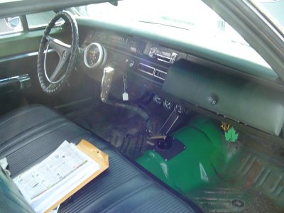

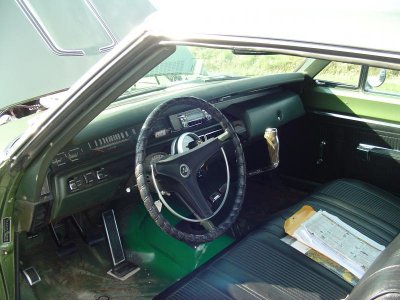

i have the tremec in my hemi car. very slick set up but definitely not old school. i am using 3;90 rear and would go to 4;10 if doing over. i also went hydraulic clutch which eliminated a bunch of linkage points.

Thought about the hydraulic clutch route. I'll see when I get closer to that point. thanks for the picts...

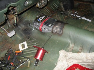

here is a couple more
