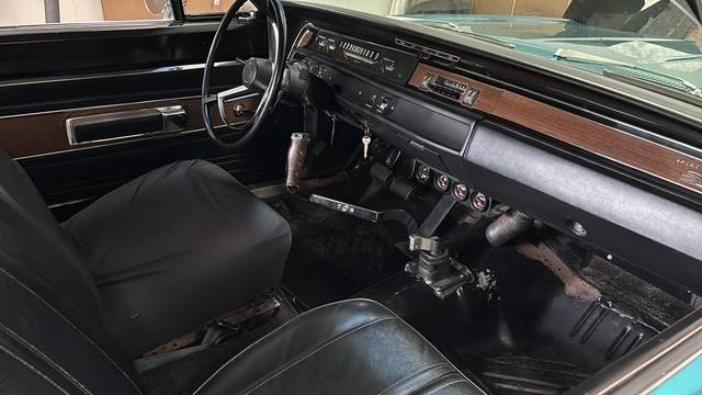

I did my Tremec swap in 2021. Back then I had the 440/493 with about 10.17 compression and the Mopar '528 solid cam. It was a great performer and would accelerate in 5th from 1000 rpm quite easily. The longer stroke crank helped with torque. The cam went flat though so I had to pull it all apart.
I rebuilt the engine in 2022 using better pistons but with 9.8 compression. I re-used a Lunati cam I had here to save some cash. It is a bit wilder than the '528 was so it is not as peppy at low rpms. It does not pull clean from 1000 like before. It hesitates a bit until about 1500-1700 rpms...from there it starts to pull nicely.
Cam duration matters a lot.
The TKX uses a .68 5th gear, my TKO has a .64, close enough to not matter much. The 3.55 in 5th gear is 2.41 in the TKX and 2.27 in my TKO. Going to a 3.91 means a 2.65 with the TKX and 2.50 in a TKO.
