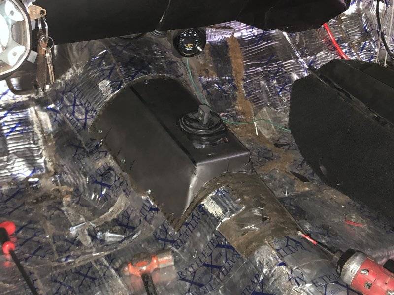

Your question requires a bit of clarification.Will it do this for a real 4 speed car? I wasn't aware there was any Tremec transmission swap that allowed for a stock location of the shifter.
If there is, a link would be appreciated.

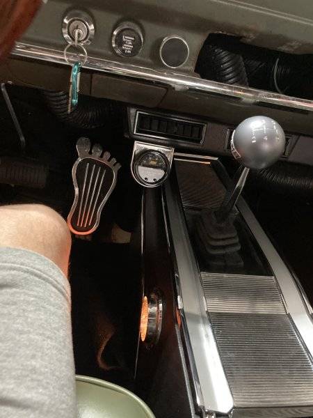

My Tremec swap resulted in the shifter appearing like stock. Under the console lid, the stub on the transmission itself comes up from the center but the adapter and aftermarket shift handle assembly connection are hidden.
Now for a stock 4 speed hump, I’d suggest removing the hump and welding a patch over the hole.
