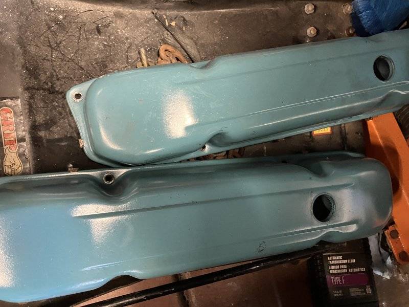

Going for stealthly stock look underhood with everything painted turquoise. What are the options for the 240 that are available?

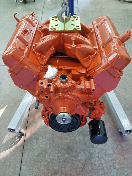

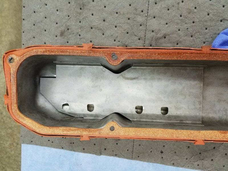

Here's a stealthy look for a 440 / 505 stroker using Trickflow 240's and the original 1969 valve covers, Hughes 1.5 roller rockers. Only had to clearance the inside baffle, otherwise fit perfect!

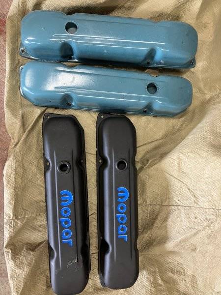

THIS. I also shaved off the logo and was hoping to use the stock covers (67 383), but its a matter of finding them at this point.
I'll do some checking/calls and get back to you. Thanks!
So a search of T/f said they fit with stock covers. Hmmm. I called my engine guy and he said he had to open bolts holes to get them on which I can verify.
