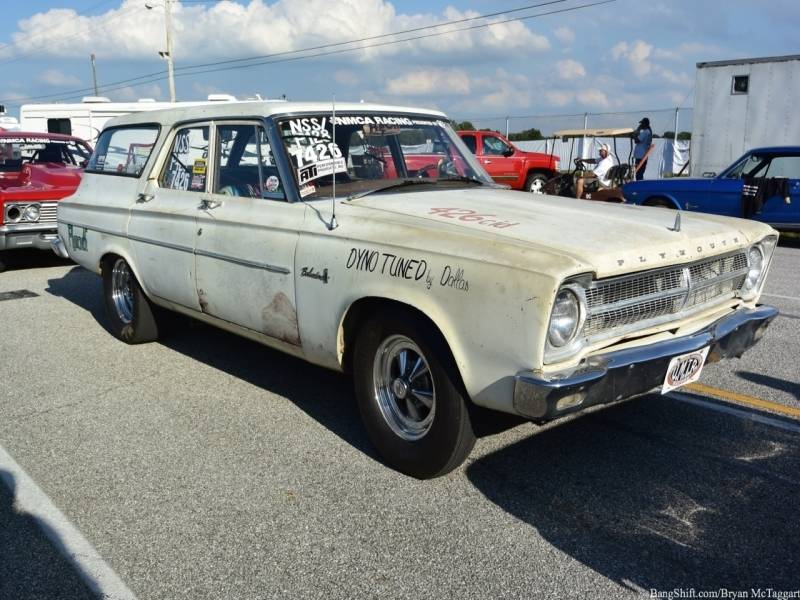

Went to the track this weekend and i have been tuning on the car and have gotten it to the 12.10-12.12 area very consistently but... I really need to be in the 12.02-.04 range to be competitive because it is a 12.0 index for NSS. So I guess Im asking are there and small tricks other then losing weight! I was thinking of putting synthetic grease in the front wheel bearings and going through the front brakes and cleaning everything making sure they roll smooth because i think Im giving up some there just though i would pick every ones brains
Here is the list of things i have done:
adjusted timing until i gave up mph and ET so i found its happy spot!
put 90/10 front shocks and qa1 rear shocks and have them to where the 60' is deadly consistant1
pulled all extra weight i can think of with out losing the seats or stockish interior parts!

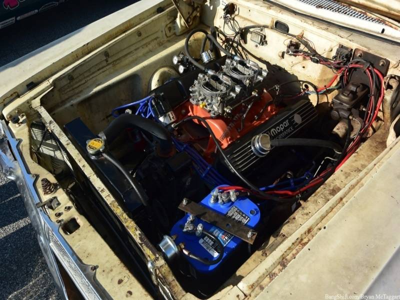

engine is 440 .040 over 12.5:1
906 heads ported by cfm performance and bigger valves has a .570 lift FT cam with HS 1.6 rockers
running the eddy dual 4 inline intake and has 2 650 eddy carbs
4 speed trans with adjustable soft lok McLeod clutch
open headers and no air cleaners
thinking about making a air pan and doing a scoop hoping to squeeze that extra bit out of it as crazy as it sounds i dont want it to pick up to much!!
fuel system is a billet holley pump with 5/8 aluminum line to a fuel log with 2 new regulators to individual lines to each carb @ 6.5psi each

"The car is all steel no fiber glass....yet" - That's going to help for sure. I noticed you have Cragar rims. While they are very cool, they are heavy compared to aluminum rims. Used rims can be picked up for a reasonable price but it all depends on how you feel about your Cragars.

If those are old-school steel cragars try running an ultralite wheel...it ought to save you 10 lbs...
Couldn't tell in your pic but if you have a cast iron wp, pick up an aluminum one of not going electric...lots of weight savings there too...
