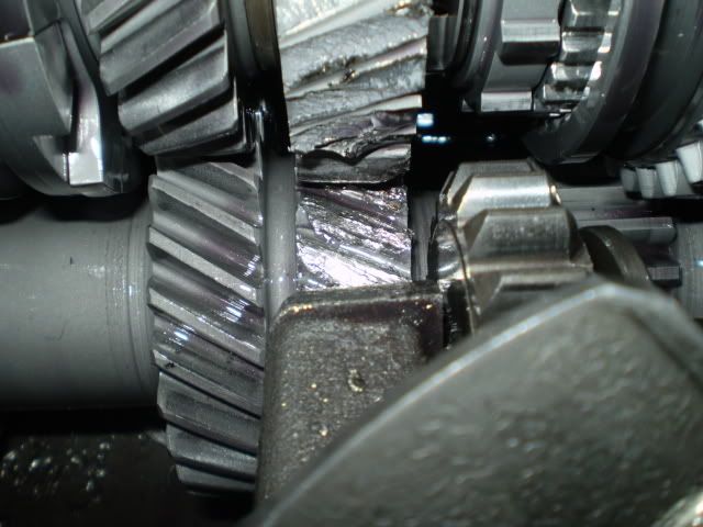

What clutch were you running?You'll like the face plating, I loved mine. I just couldn't get a 833 to live in my dart. To damn heavy for the power.

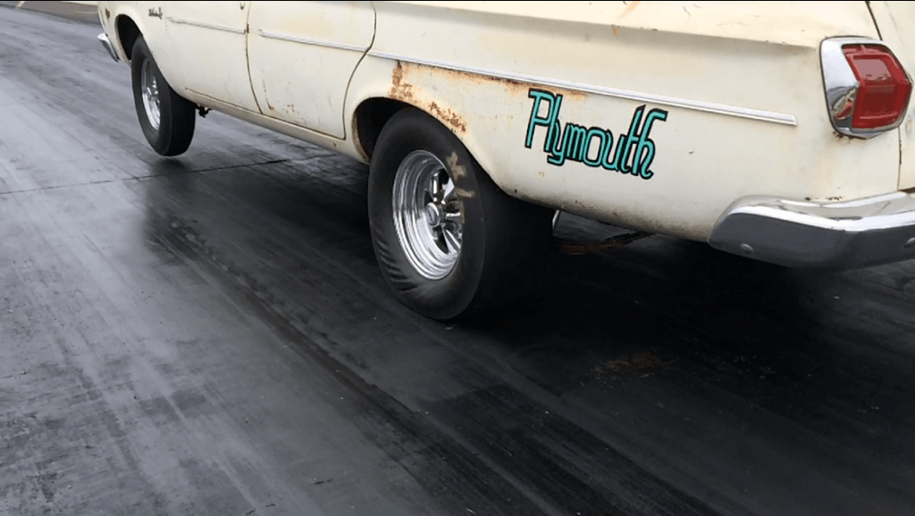

it does pull the front wheels about 3-4 inches every passDoes your car pull the wheels up out of the beams?

the front end lifts when going down the track, look at a video of your car, get a floor jack & raise car up like it is in the video, set the toe in alignment to 0 & also air up the front tires to the maximum air pressure.
what was the engine combo the trans wasnt the problem the setup on the clutch was off! these transmissions can only take about 1300#s plate pressure total and if you exceed that they will break mine is a dead stock 23 spline 2.66 first gear box and i have never broke a thing yet because i make it slide the clutch a little down low and use counter weight on the high side to lock it up!I went through 3 hemi four speeds in a pretty short period. After that I put a TF in. Might do a jerico some day. The one in the video was sweet, had a 2.93 first gear! That hurt to break that..
I had the base turned down (where Tim told me to run it) but you gotta figure the car is 3800# with me and is around the 700hp mark. Just more than what them things are ment to handle. It's a quick street car, usually runs 10.30's at a good track with a 727. If I gotta lift between gear changes to make the 4 gear live then it's not the right 4 gear for me.
