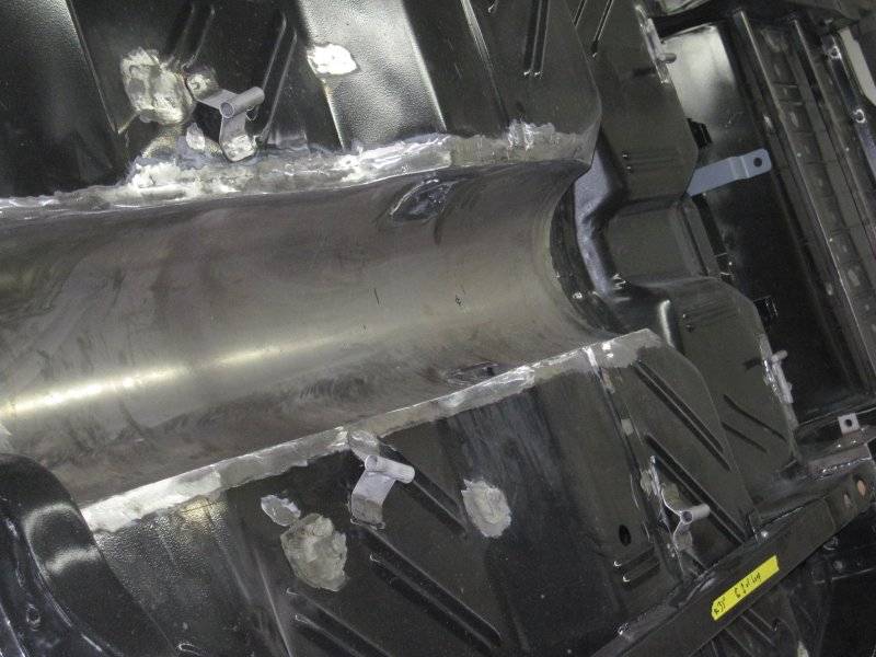

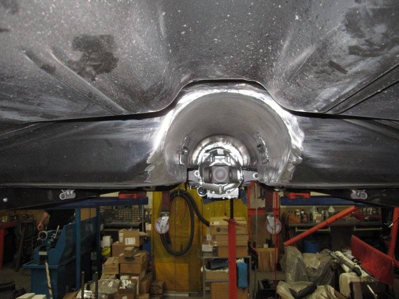

I replaced the whole tunnel in my 65 for clearance around my GV. It was hard to cut up the reproduction floor I spent so much time to weld in!

Thanks for sharing. That will give me an idea of how to shape the new tunnel
I just had a local sheet metal shop roll my chosen radius in my choice of metal gauge with extra hanging down to account for floor irregularities, trimmed in place after tack welding.

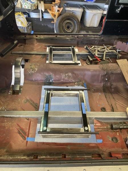

When I get the back end of the car wrapped up, I'll be tackling the passenger floor. I boogered it up making room for my GV unit plus since I'm using a 70 k-frame, engine/trans moved back 1.5". The floor had numerous cracks from before as the PO put in bucket seats but it was a bench car, so no stiffeners under the buckets which led to cracks. From there, I cut the floor up for SFC's and made a new upper t-bar/trans hoop to give the trans more room for airflow. With all those issues I'll being making new floor panels, plus trans tunnel, from scratch when I get to that area. This will be a great area for me to get re-aquainted with my metal forming machines and skills I learned 10 years ago. Its been 6 years since I've used them, so the floor will be a great area to get back in the groove.
When I get the back end of the car wrapped up, I'll be tackling the passenger floor. I boogered it up making room for my GV unit plus since I'm using a 70 k-frame, engine/trans moved back 1.5". The floor had numerous cracks from before as the PO put in bucket seats but it was a bench car, so no stiffeners under the buckets which led to cracks. From there, I cut the floor up for SFC's and made a new upper t-bar/trans hoop to give the trans more room for airflow. With all those issues I'll being making new floor panels, plus trans tunnel, from scratch when I get to that area. This will be a great area for me to get re-aquainted with my metal forming machines and skills I learned 10 years ago. Its been 6 years since I've used them, so the floor will be a great area to get back in the groove.View attachment 1498695
Those seat brackets look like Scat universal brackets?
