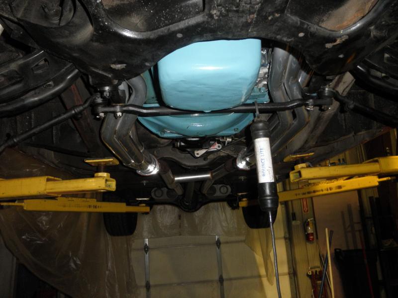

A small ding el do ya for the idler arm (mine-psgr side) would not prevent me from getting the ceramic coated. You can see it if the car is on a lift, but it has not compromised wear or perfomance that is detectable. The heat reduction in extended summer idling is priceless.

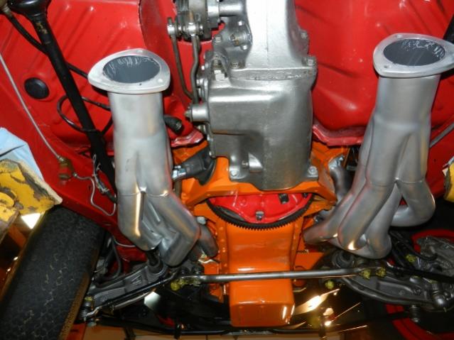

nice fit..426 Hemi in a 67'R/T, or RB "63
