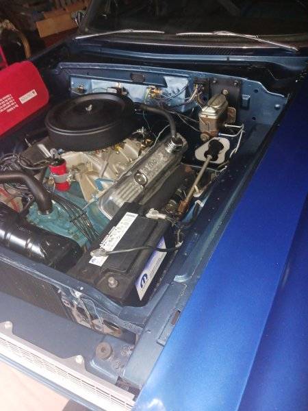

Hey Bob, what engine, and manifolds are you running in the Belvedere ? I haven't seen it since you finished it ?

Used the best mounts Schumacher front and mancini poly rear Went with factory 65 BB duel exhaust manifolds still trying to find a trans dipstick that does not hit the manifold they all hit where the manifold turns down rebent one not pretty but works and for Vandan it runs and drives nice no more show cars for me can take it to the store and not worry about it will repaint it back to original color maybe
