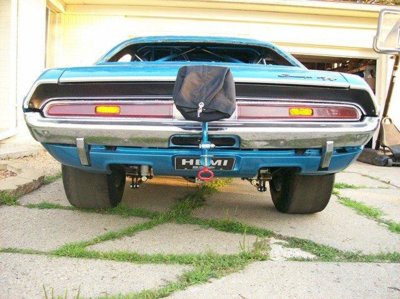

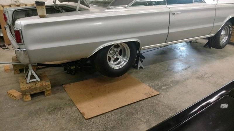

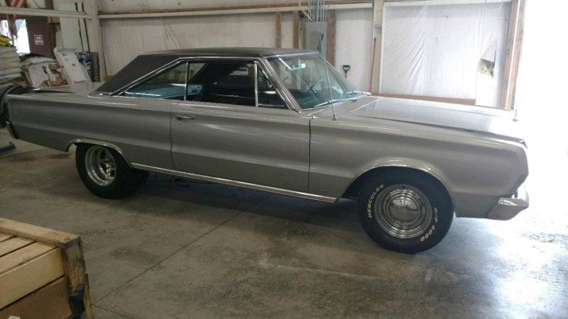

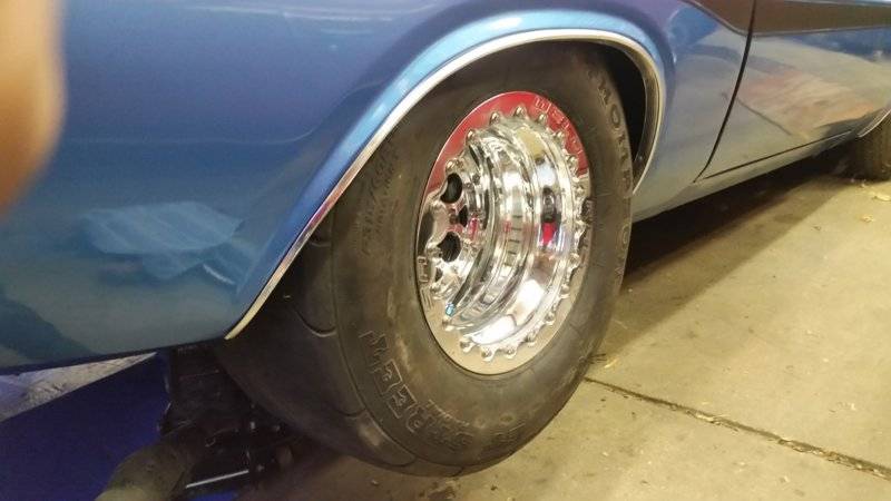

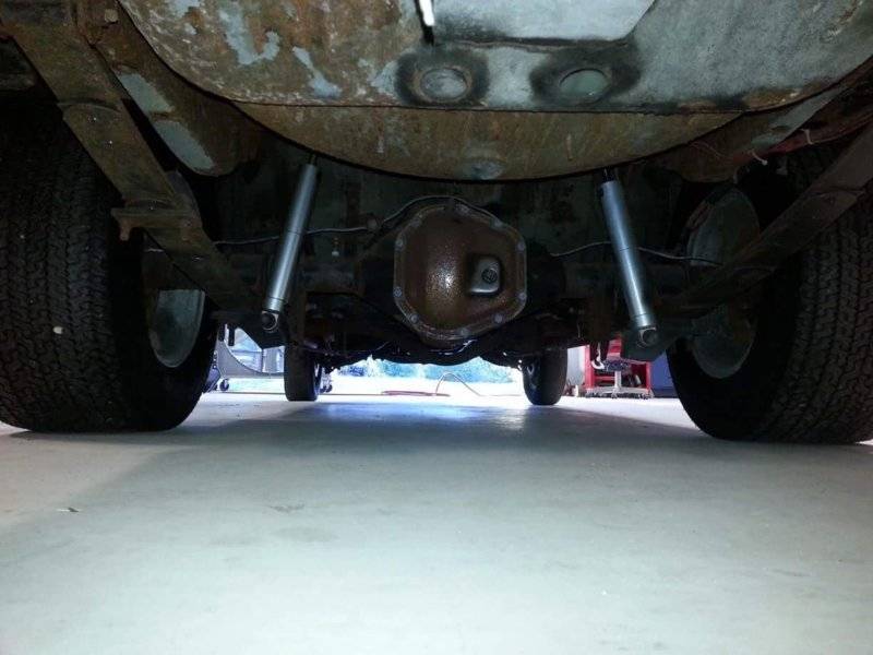

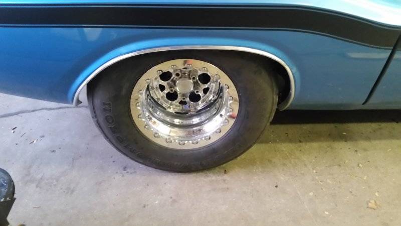

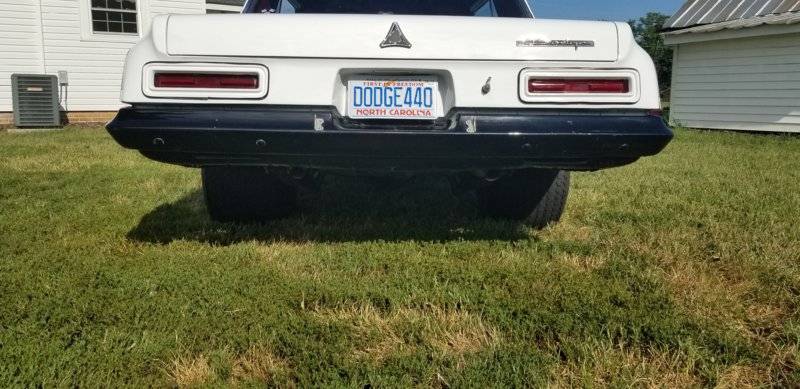

Mine is minitubbed to the frame rails. Have had N50 tire on it and it fit well. I replaced my quarters and now actually have a wheel well lip that makes clearance an issue. Sent my housing to Cranky to shorten the rear 2 3/4" ....should be no problem when I get it back.
These are old pics

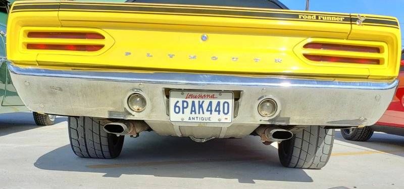

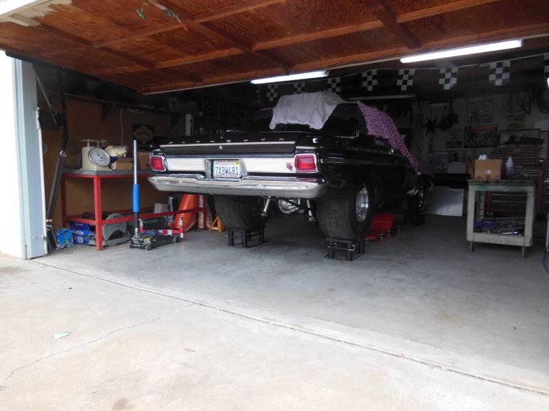

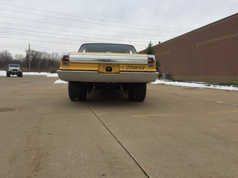

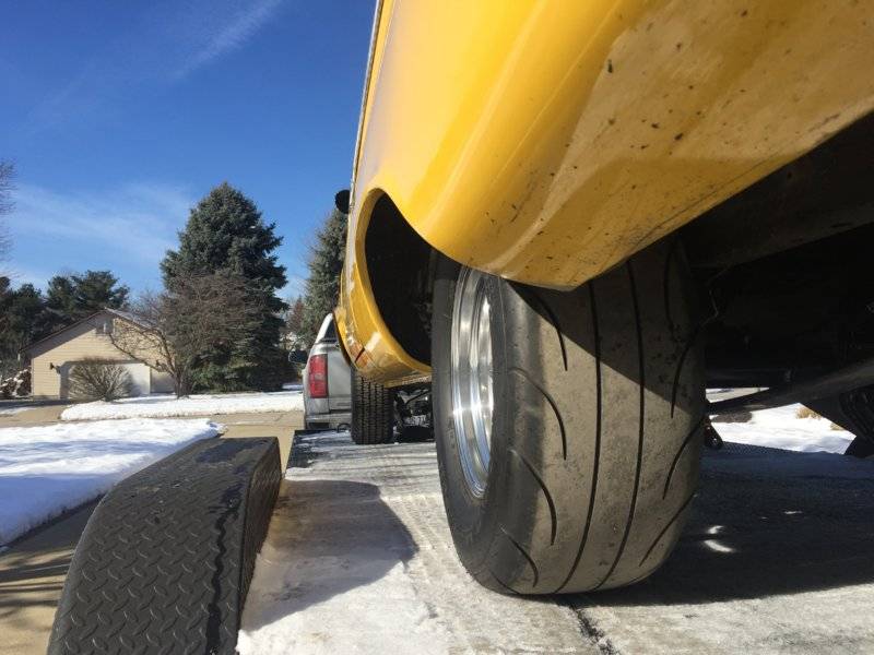

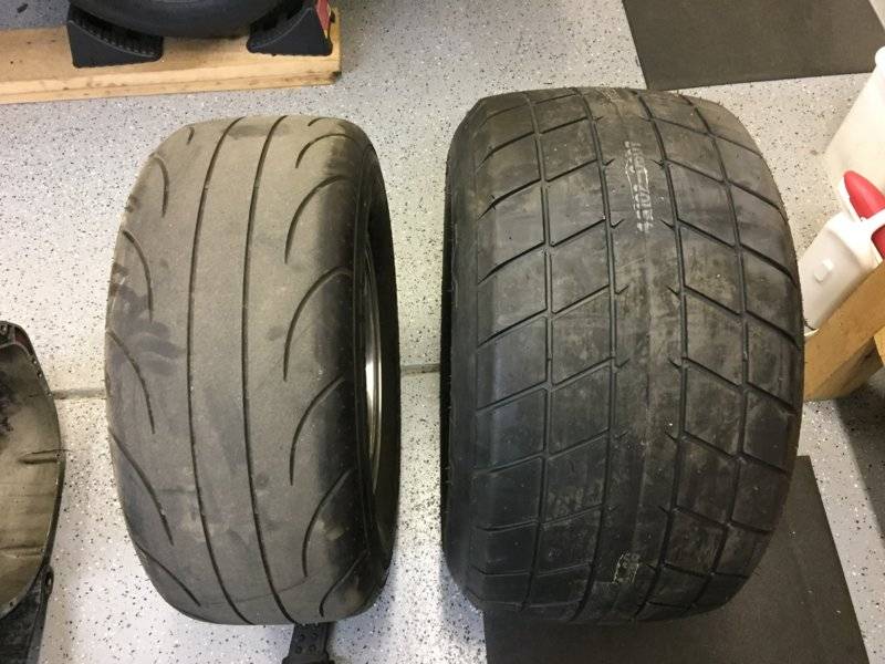

12 inch wide rim with 29/10.5w tires measured 14.2 tread width big tire look using a mini tub
IMG952018051695185126431_2.jpg IMG952018051795155539105.jpg IMG952018051695185017178_2.jpg

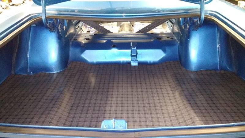

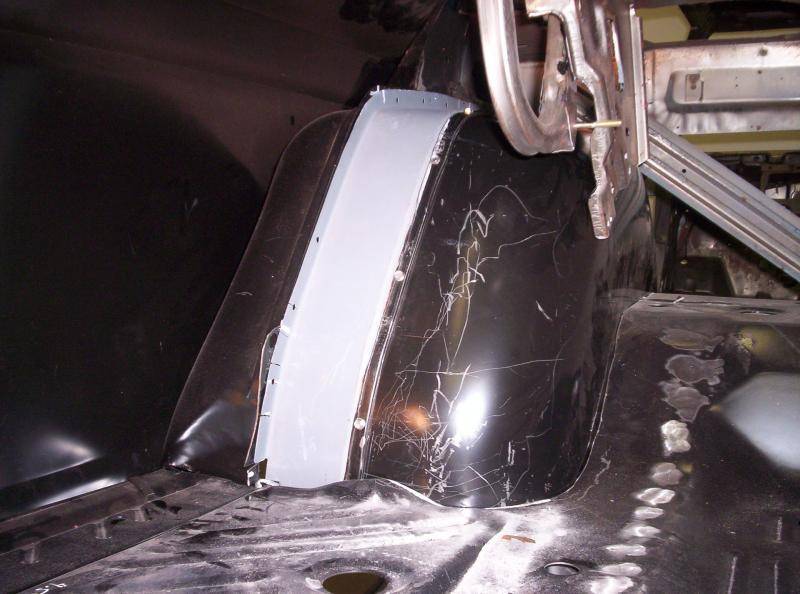

I like the minitub route. Like malex said it helps keep some of the structure in the back half of your car. And also you can keep the stock look in the trunk if you want. Also depends on the car how much wheelwell you need. A 66 Cornet needs more help than a 69RR.

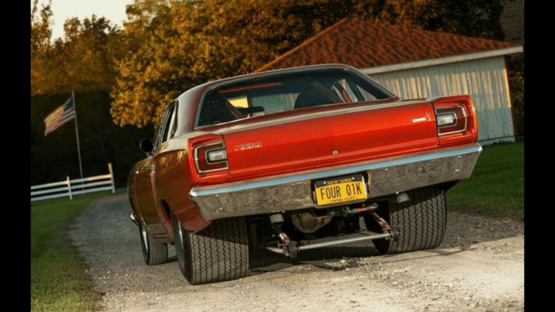

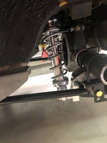

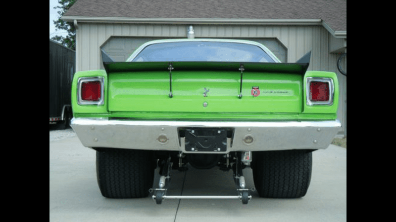

These are on my 69 GTX. One thing I didn't think about was the vent lines for the gas tank, you'll have to rebend or make new one to keep the oem look.

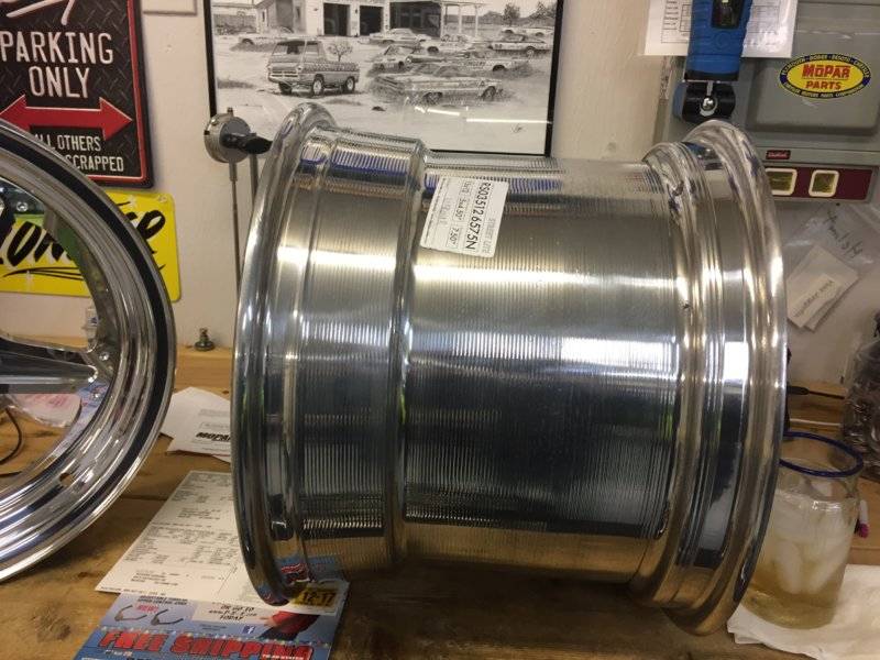

I currently have 325/50/15s on 15x10 wheels in there with room to spare.

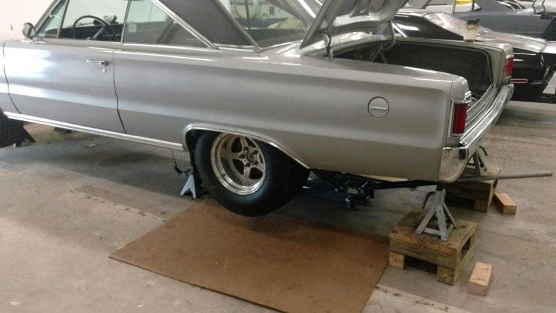

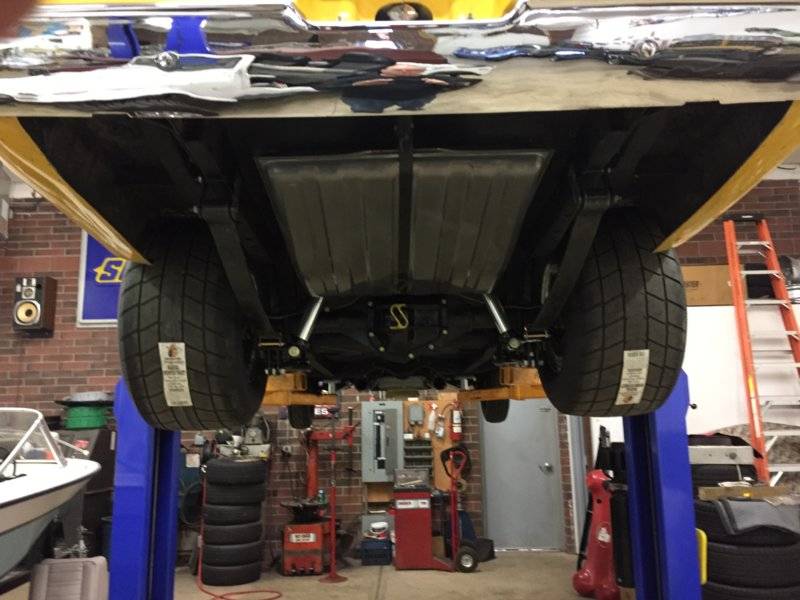

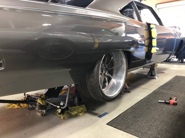

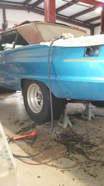

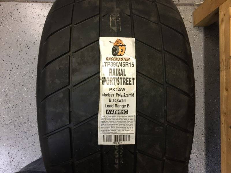

I still love the tubbed look on any car and have done both also. I will probably tub another one someday. Currently, just have a mini-tub in my Challenger. I can fit 315/60/15 Drag Radials or a 29.5X10.5W in with more room to spare.
