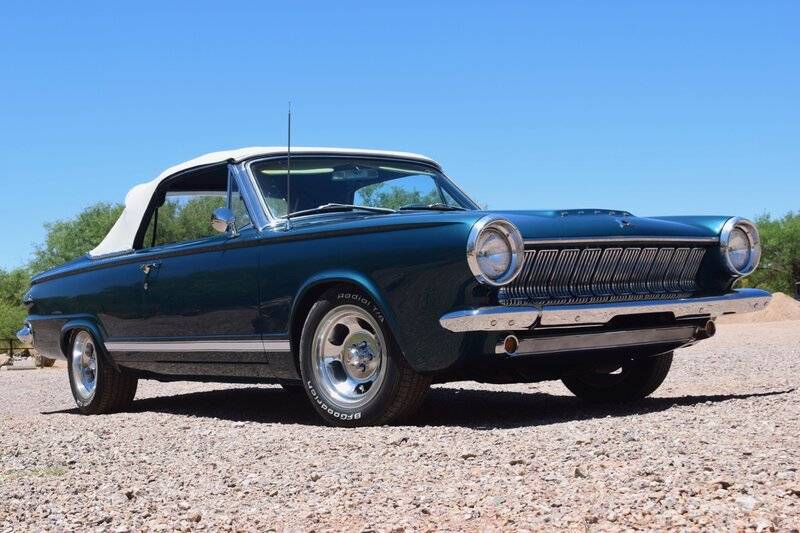

Our '63 Dart convertible. Nicely hot rodded /6 that I find I like driving better than anything else we have.

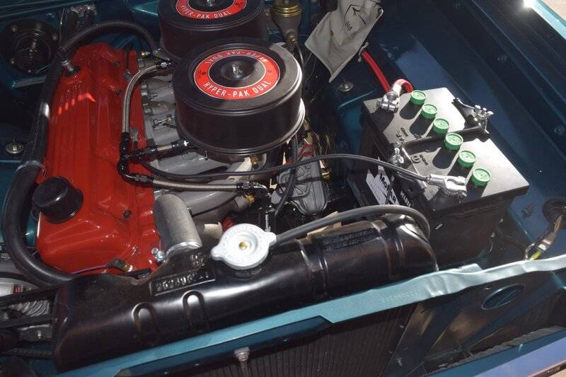

I have never had a 4 barrel but the typical suggestion is to run about a 350-400 CFM 2 barrel for drivability, it is reported to be hard to get a 4 barrel to work well anywhere but WOT. I am running 2 one barrels at about 450 CFM, decked block with 9:1 compression, Oregon Cams 2106 cam with Dutra Dual cast iron headers and it runs great from idle to WOT. This is the wife's car and she manages in traffic without a hitch.

Hey Jim, Great looking '63 Dart. I learned to drive in a '63 GT Dart. I always said Darts were the 1st "pony cars". they were on the streets 1 1/2 years before the stangs showed up. 2nd car I ever owned was a '64 dart vert, just like yours only red. Great memories.
I was on the fence when we bought it to restore but the way it came out blew my mind. We simply love this little thing.
