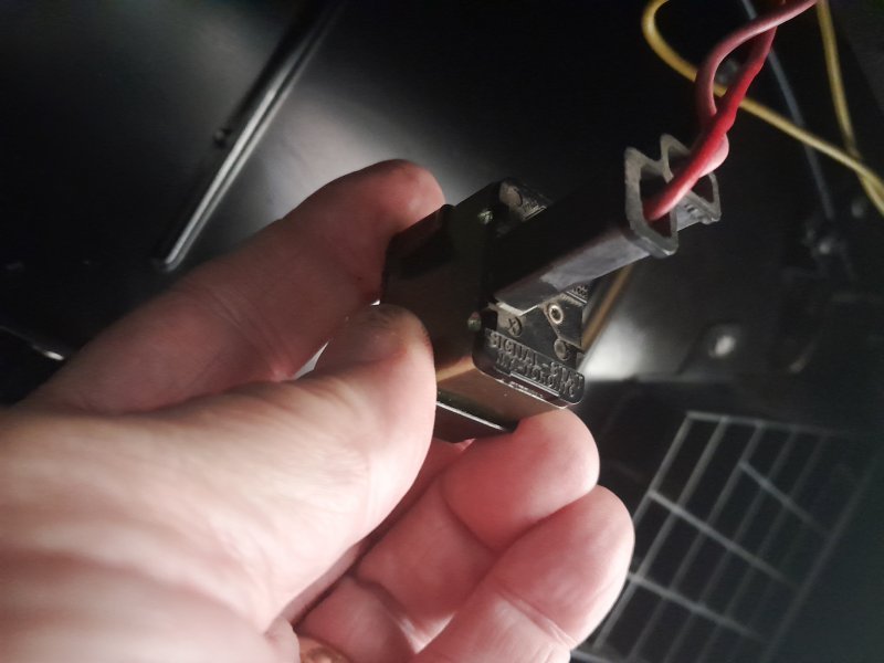

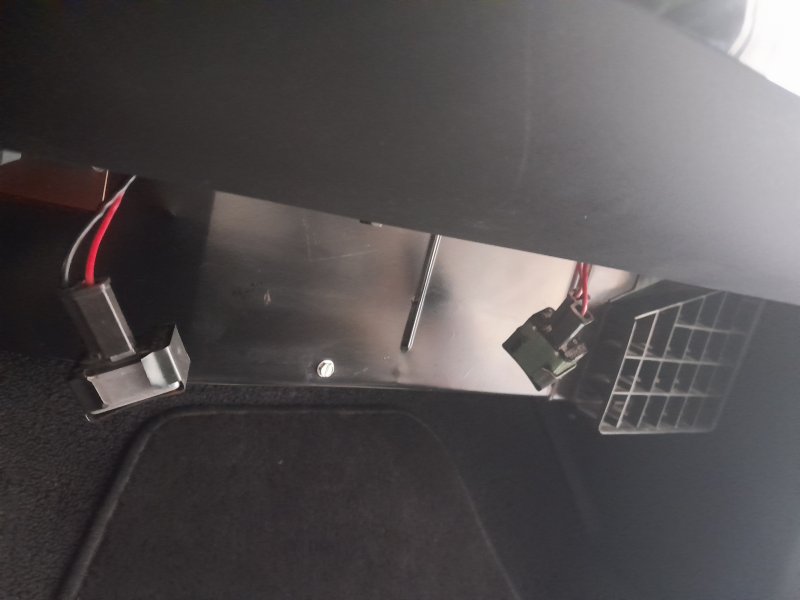

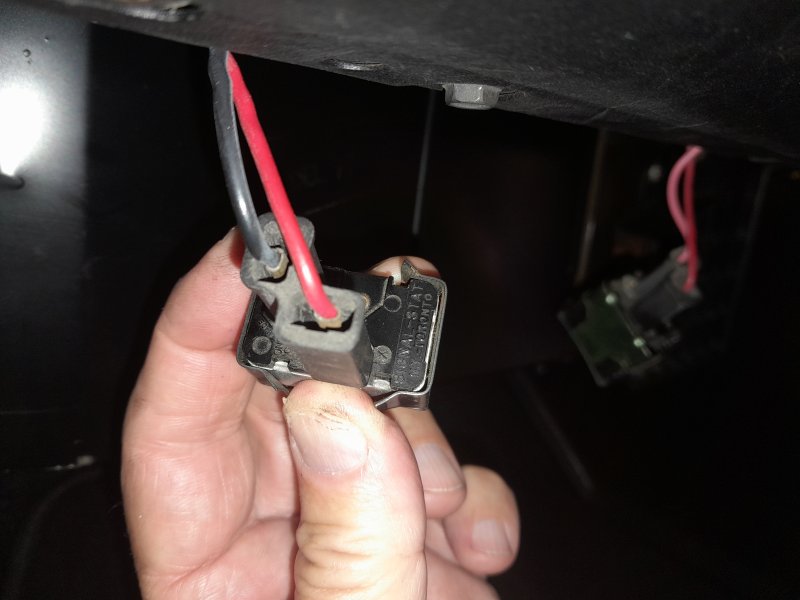

Just now starting to inspect lighting on this vehicle I bought a year ago. Service Manual says flashers are to right of steering column in brackets mounted to ash tray housing. NOT! On underside of passenger side dash in clip-on holders. Pretty sure these are them (pics). Per Service Manual, red and black wires are for turn signal flasher; pink and red for emergency. Looks like a match to me. Based upon how difficult it was to dislodge the holders' clips, seem to be originals and never changed out before.
Any idea where to find a like replacement for the turn signal flasher? Thought I'd try that first before chasing bulbs.
Have you tried removing the respective flasher from its holder?? Unplug it from the harness....is there a model number, part number and or manufacturer's name? Google search the info collected for a local source or equivalent......just a thought....
