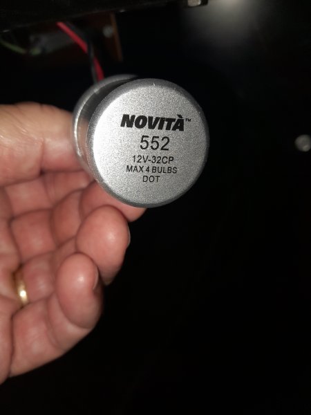

Hope this thread isn't getting too old. Here's my turn signal flasher. Did Google search - came up with Honda bike and 63-64 Corvette, NOS and used flashers with same 142 designation but asking $30+. Thinking I should I try the $4.49 Napa 552 you're suggesting. If doesn't help will look at remaining bulbs (front are all good). IF that doesn't do it, I did see on another thread that a worn turn signal switch in the steering column can sometimes be the culprit.
NAPA has an electro mechanical 552 flasher with an electronically controlled flash rate. My hazards flashed way too quickly and the NAPA flasher cured it. I suspect your current flasher is weak causing it to cycle too fast.
The 552 did it. Got mine at AAP, Novita brand. Thanks for everyone's help.
