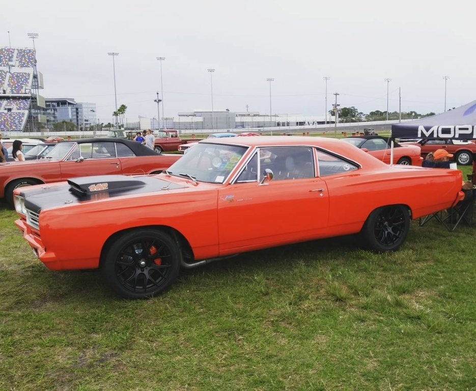

Listen, front mounted turbo's are great when you run nearly any generation SBC, SBF, or even SBM; it's quite easy to browse for the perfect log/turbo manifold through an online catalog or utilize a junkyard exhaust manifold. We don't have that luxury with a BBM unfortunately, and unless you plan on owning a dedicated project car for two or three years while perfecting a 'street friendly' setup, you'll end up like 95% of the cars on theturboforums that are never completed due to over-complexity. Sure, you can remove your inner fenders, run a coil-over suspension setup, install an aftermarket k-member, ditch the torsion bars, and provide yourself with ample room for installation for a front mount setup. Then, you run into the problem of either A) running twin 3.5" diameter downpipes to the rear of the car, possibly merging into a 4" single unit or B) running a 5" down-pipe, dumped out the front fender after merging the two 3.5" pipes from your twin-T4's. Now I'm talking a street friendly setup, something you can drive in traffic, to the car show, and take short trips to the beach in without worrying. You can't dump a 5" exhaust out the fender and plan on driving the car to the local cruise in, that isn't even an option. You certainly can't run 3.5" diameter pipes through the tiny crevice of a space between the block, frame, and torsion bars. Once you actually sit back and think about it, it's quite difficult to understand the complexity until your 'knee-deep' in it. Please read my entire thread on theturboforums to understand what the 'average' guy is getting into, prior to starting on this sort of project. It's fairly straight forward, but I did make some mistakes along the way and corrected them by the end of my journey.
Cost wise, you're looking at around $3,500-$4,000 total. That's with the A2W intercooler setup, snow performance meth injection, CSU carb, MSD electronics, fabrication at the shop, turbo, etc. I did purchase quite a few of my components second hand however.

My advice;
Read my entire thread to get a realistic expectation to what is all involved. Throw out everything you've learned about N/A engines, and pick up a copy of Corky Bells 'Maximum Boost'.
If anyone is realistically wanting to do this, I would cut a SERIOUS deal on my MSD 6AL ignition box, boost-timing master, and Snow Performance Stage II kit.

Boost is boost, it doesn't really matter where it comes from (front or rear mount). You're maybe looking at 20-30HP @ 6-8 PSI difference between a front & rear mount if running an identical turbo (rear mounts are usually spec'ed a bit smaller for quicker spooling). Also, my hot side is wrapped to retain as much heat as possible. I'm actually moving up to a 9" FTI 4800 converter and back to the MP .590 solid that was in the car previously. My current camshaft with 240 @ .050/112 LSA isn't cutting it, as my cylinder pressure has risen significantly, therefor, I can't really run any more reliable boost on pump fuel w/o meth (which kind of defeats the entire purpose). The car sounds unbelievable with the MP .590, and it's real easy on parts with its slow ramp-rates and relatively low-lift. I've had some of the faster ramp rate camshafts in this car, and they seem to wipe out fairly quick in a street application.
