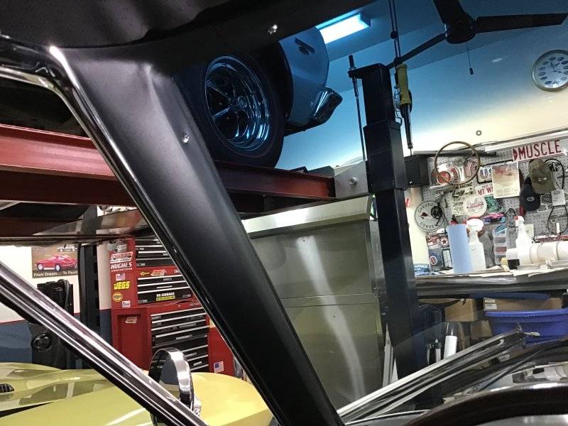

I used SEM Trim Black on my 66. Some may consider it not textured enough but I was happy with how it turned out. A pillar and top of window trim on a 66 get blacked out unlike a 67

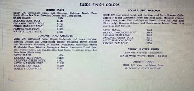

Suede is an interior paint used on dash frames and steering columns.... When fresh it does have a lot of texture to it... Many use satin paint because it looks closer to what 50+ year old suede paint looks like... But if you want it correct suede is correct...

Suede is an interior paint used on dash frames and steering columns.... When fresh it does have a lot of texture to it... Many use satin paint because it looks closer to what 50+ year old suede paint looks like... But if you want it correct suede is correct...View attachment 1521089
Suede
